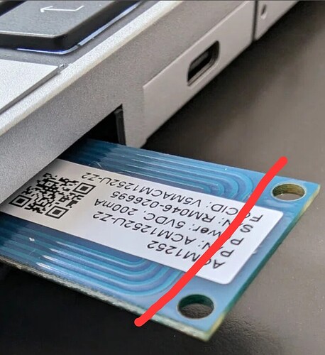

@b42 if you are active on that blog, these are some thoughts for you to pass on if you would like
The poster is struggling for space,
Here is a simple ~8mm he can gain back with the use of a dremel or similar
This is not going to allow him to have it NOT protrude as in the picture, but for some of his internal options, that will be significant
~ With the 8mm removed, that fit will be easier, AND for this :point_down: below
Personally, I would do two things
  1. Desolder the micro USB port, and attach wires direct to the pads ( I would also do that approaching from the component’s side, explained why in the next step)
  2. Once the USB port is removed, I would remove the ~5mm of PCB where it used to lay ( if there is a struggle for height with the cable ontop of the board, then out the other way would still work, with the newly gained space.
This looks like the board is laying directly onto a foil sheet, I would get something to insulate the board from the foil, something like a ferrite sheet, like this
https://www.digikey.com/en/product-highlight/f/fair-rite-products/flexible-ferrite-sheets
Even thin foam or plastic would do, but not as good.
If it were my project, Those are the first tings I would try…or another NFC reader
