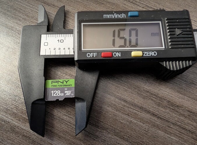

Anyone know where one might find a compact microsd card to female usb c adapter?
I want to make a local storage attachment for watch, but can only find male usb c or female usb a

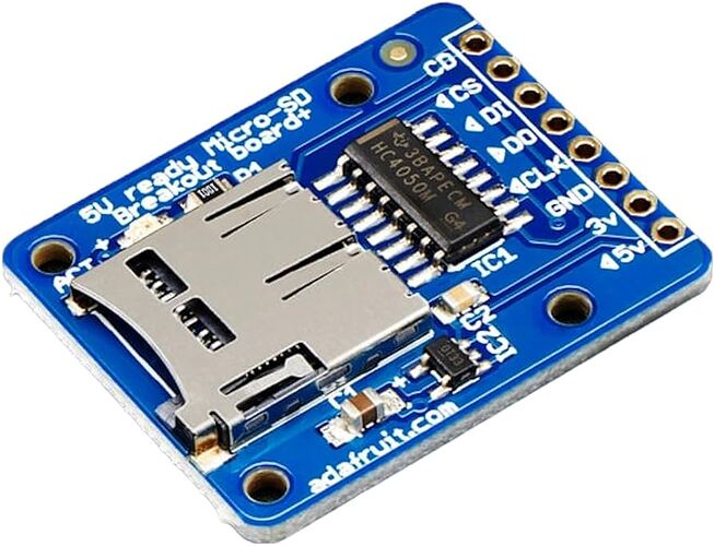

Circuit gurus…
Tell me how I’m stupid here.
Could I take these 2 and solder them together to get a functional usbc female to micro sd adapter?
Use case, design and print a small housing for such that lives on my watch band, when needed, grabs nearby phone cord, plug into adapter and computer and do data?
The Ti chip on the microsd breakout is a level shifter. It’s there to make the microsd socket safe to use with 5v microcontrollers by shifting the inputs (CS, CLK, DI, maybe CD) down to 3.3v but it’s not a USB interface. You will need a controller, likely mass storage controller, that ā€œspeaksā€ USB.

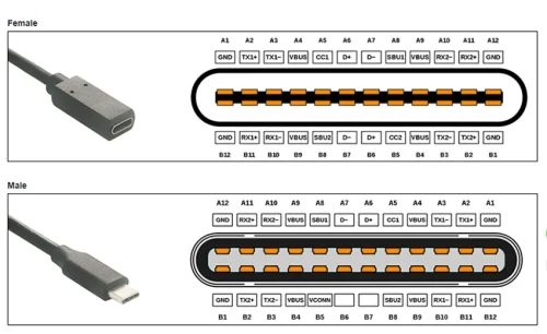

I think you’d have to physically cross all the pins, so like leftmost pin on the socket to the rightmost pin on the PCB etc. It’s not a straight swap-out.

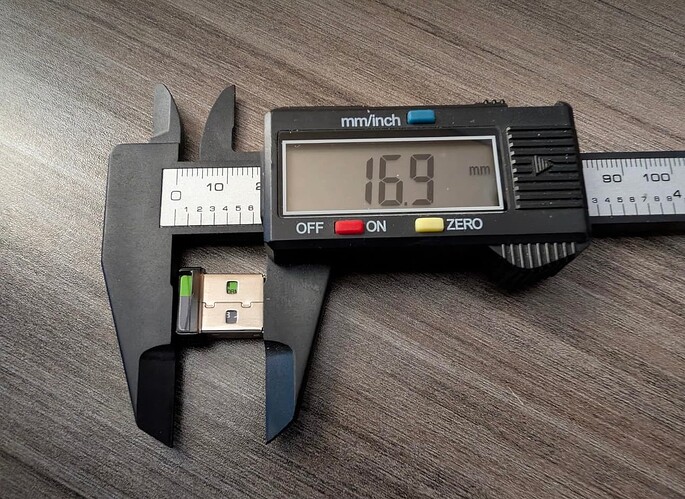

There are plenty of tiny micro sd to usb A, and then a small usb a to usb c female female
Get out of my head, that’s exactly what I was going to say…
This one technically qualifies but it’s rather big: CARD | KC7
There are chinese clones but the ones I’ve seen have Qi charging and this makes the electronics a bit large.
USB C is mostly symmetrical so that it’s reversible, and if the reader is USB 2 you’d only have to worry about the D+ and D- pins. For USB 3, things get a bit more complicated…
Another option would be to design a reader from scratch, as long as you’re comfortable with soldering tiny pins… But then again, swapping out a USB C connector will also require messing with tiny pins…
