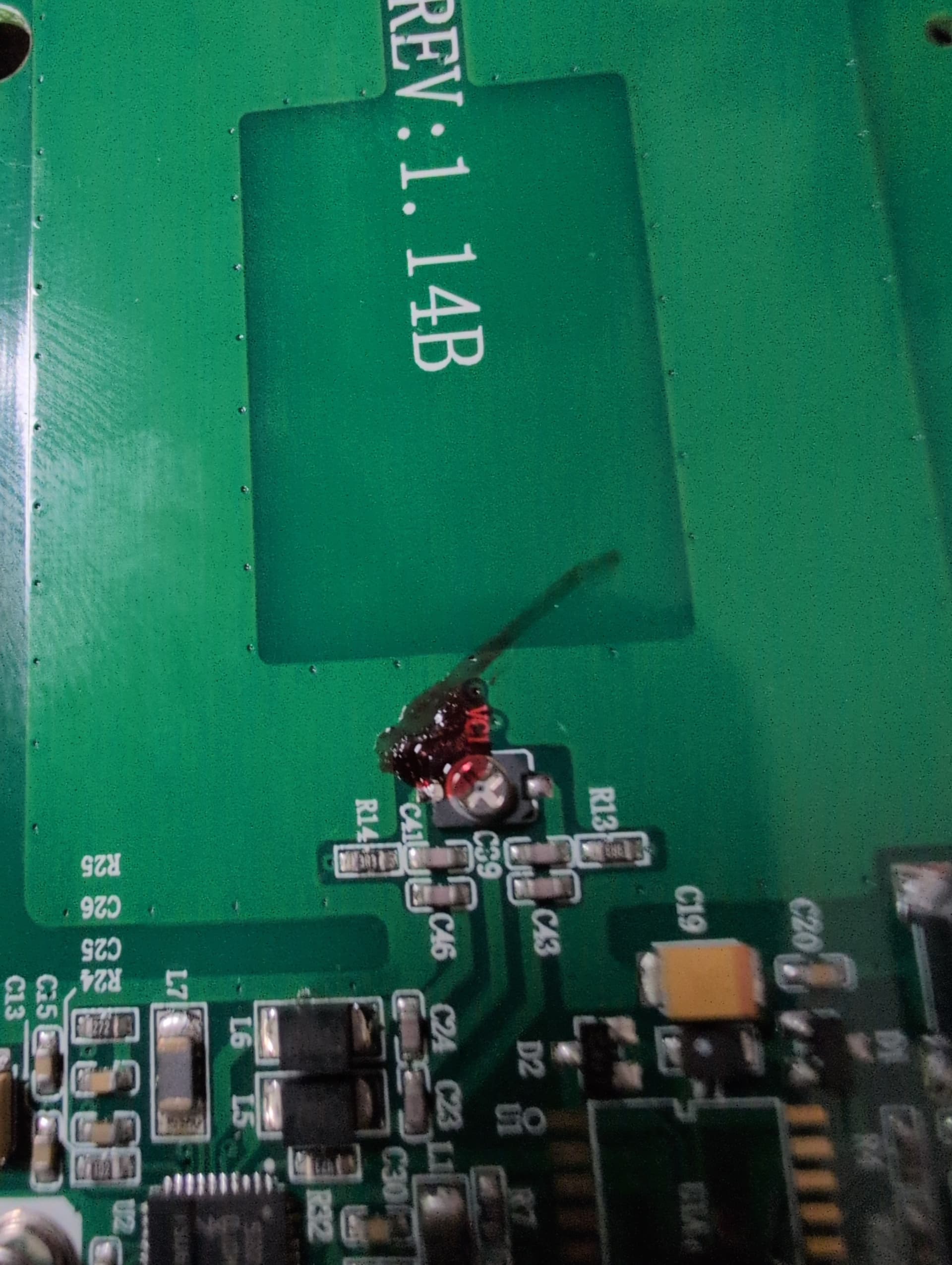

I think I fried my acr122. Anyone know if it has an on board fuse? I don’t see anything labeled F just C, R and D.
But did see that the antenna can be tuned.
what-did-you-do-messed-up
That’s just red goop to stop people from messing with the tuning.
I plugged the acr122 into a pd power supply. It beeped and turned off now it won’t turn on.
Clearly a Chinese model that does not actually respect PD protocol and just pumped a shit ton of power (high voltage) into that reader. Poor guy.

No power to the main chip when probing ground and power.
Also usually when it was plugged into a non pd power supply it would beep when power was applied.
Plot twist.
Shorting ground to power has breathed life back into it. And I even got to tune it.
If you have a nanovna check your acr122 for proper tuning!
Did the tuning actually improve or degrade performance with a test setup? I have found that many readers are spot on but some are a little bit off
 seemingly on purpose. I wonder if tuning it actually reduced performance for some reason. The ACR 122u antenna design is very black magic of course.
I have saved numbers of known distances from another project so I can test it later
avg 4mm increase over 40 samples

Although the ACR122 antenna doesn’t look too bad from the pictures I’ve seen, the shielding can make it look significantly more intimidating than it actually is.
I wouldn’t expect a fuse in something like that TBH. The USB standard specifies overcurrent in the device that’s supplying the power so adding a fuse would be superfluous. However, I’ve seen Chinese “engineers” place 500mA fuses on USB devices, but those geniuses also add fuses to the output of switching regulators with built-in overcurrent protection
