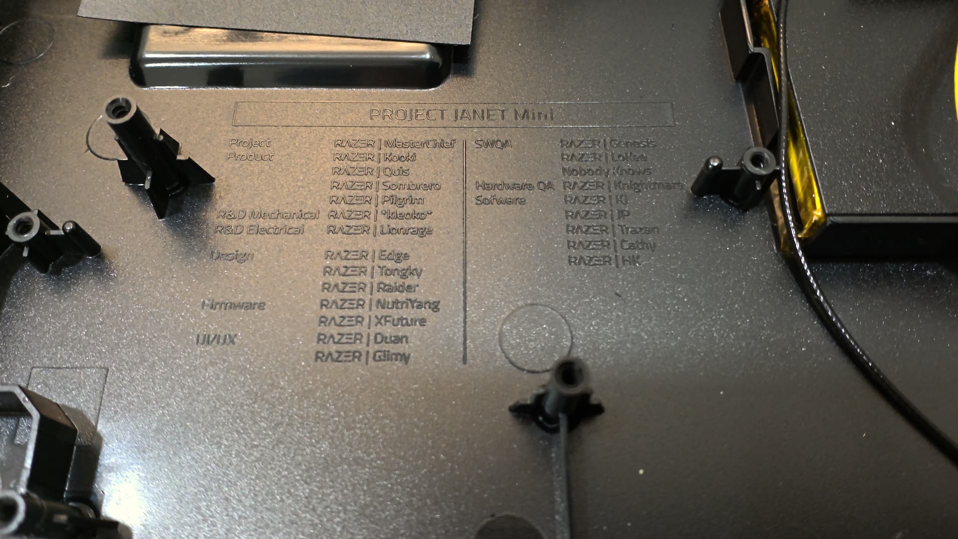

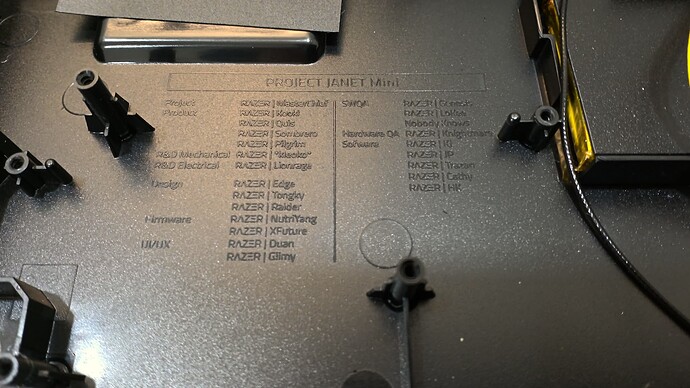

TIL that Pilgrim was on the design team of the Razer keyboard that I criticized not that long ago for being buggy:

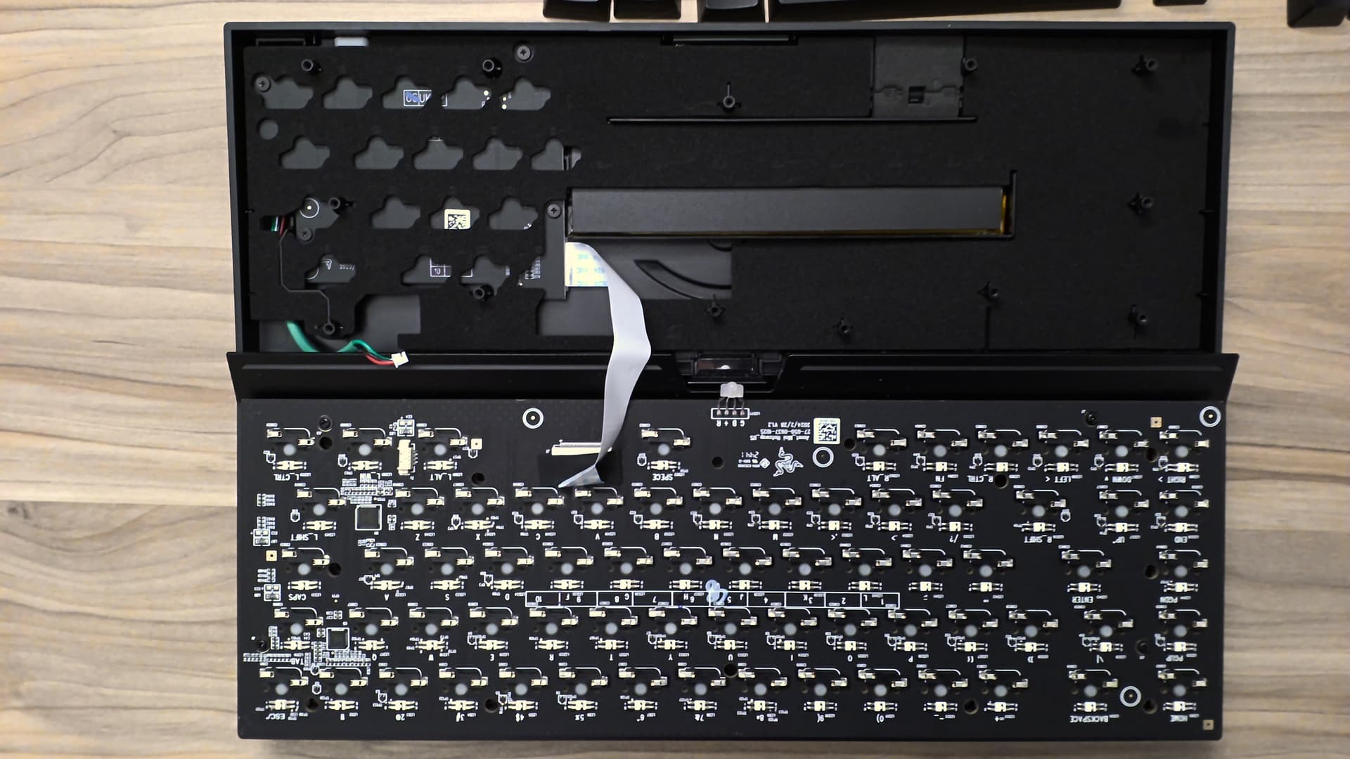

Joking aside, some comments about the keyboard
As far as the hardware goes, the two guys who actually designed it did a very good job. Although the bottom MCU PCB could’ve probably been a single sided load design instead.
On a side note, why is the project manager going by the name of ā€œMasterChiefā€? Very PM of them. :thinking:
On the firmware and software side of things, well, this thing is messy. The wireless and RGB are unreliable, on a wireless keyboard that includes keycaps that require backlighting for the characters to be visible. And don’t get me started on Synapse, Windows Dynamic Lighting support, and how the pairing two devices to one dongle breaks things.
ā€œNobody Knowsā€ did the SWQA… :thinking:
But at least is has nice foam and the typing experience feels great when it works:
I think that I’ll ultimately settle back on my old 65% Asus keyboard that I have and buy a lightweight non Razer mouse. Somehow these guys managed to create a product that’s good enough to get past the return period but might drive you up the walls with a future software update.
In the grand scheme of things, I can’t complain. I bought a mouse and a keyboard to save a USB port and dodged the bullet of buying one of their laptops.
:robot_windows:
Edit: Why does Razer add polyfuses to every single USB device? Does a little receiver dongle that’s little more than an MCU and an antenna really need one? Besides, all USB host ports are required to have overcurrent protection. And if there’s a short, it’ll probably happen in a cheap chinese cable instead of inside of your product.

Is it a wired mouse?
Wireless keyboard and mouse. But they can be used with a USB cable. There’s a polyfuse in the keyboard itself, and another one in the tiny receiver thing.
I still have to take the mouse apart to check, but I suspect that it has one as well. And I also suspect that most other companies are just relying on the USB overcurrent protection instead. Besides cables are bound to be the problem instead.
Well redundant safety features aren’t a bad idea, especially in mechanical devices where the user could induce a short by using the device incorrectly or dropping it. Polyfuses are also included sometimes for transient voltage suppression when the cord becomes an antenna for external signals
Along with TVS diodes, ferrite beads, etc…
Meh, I’m just thinking that it’s a weird design choice in this case. Just like having SMD parts on both sides of a big low density board or having a separate antenna when it could’ve been on the MCU/wireless board that sits on the bottom of the keyboard right against the back of the case.
At the end of the day, It’s good hardware and I have nothing to complain about, I’m just lonely and want to talk shop. On the other hand, their firmware and software is junk.
