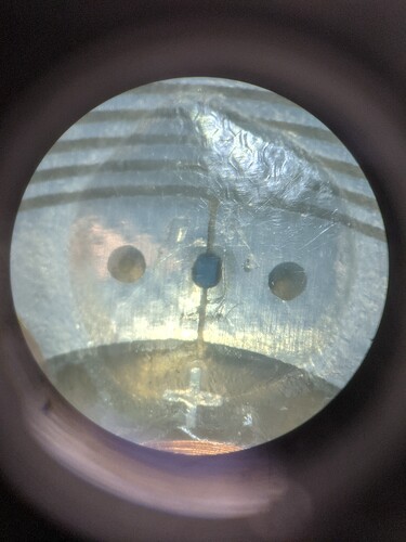

Not testing stuff but just a little update… the resin used to protect the chip and LED passive components seems to be working well enough during the encapsulation process, and it has an added benefit that it sort of acts like a light pipe with lensing effect, spreading the LED output across a wider angle.

Happy accidents
well first my leds went out and now im not getting any read from the ntag any more, my t5577 is still going strong tho
Yikes. I’m hopeful the FlexMN lasts way longer (preferably for life :sweat_smile:)
at this point i have doubts about my resin based mitigation for the LEDs … but the chips (magic ntag & t5577) should last a heck of a long time
