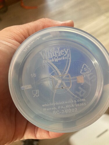

I have here an RFID tag in a beke that is used in coke freestyle machine, I tried to read it with the Proxmark but to no avail.
With what might this one be read?

likely a hybrid UHF mag couple tag
Maybe a uhf? better range, and it would explain the prox not recognizing it
Cyborg prime beat me to it
I found some discussion online… From roughly 2004 to 2018 ValidFill used 13.56MHz RFID… In 2018 they switched to 902.75 - 927.25 MHz UHF tokens.
Can we get more info on what it does?
This Reddit post has lots of technical details but in short it will only dispense to authorised cups, and can be configured to disallow refills.
I went to Disney and Universal recently, and grabbed a cup from both. I don’t remember the proxmark output, but when I get home later this week I can scan them again.
Like people said earlier, the chips are used to limit/block refills. Ex: Universal only lets you refill the cup once every 10 minutes. There’s also usually a pressure sensor or something, so the reader is only active when there’s actually a cup on it.
