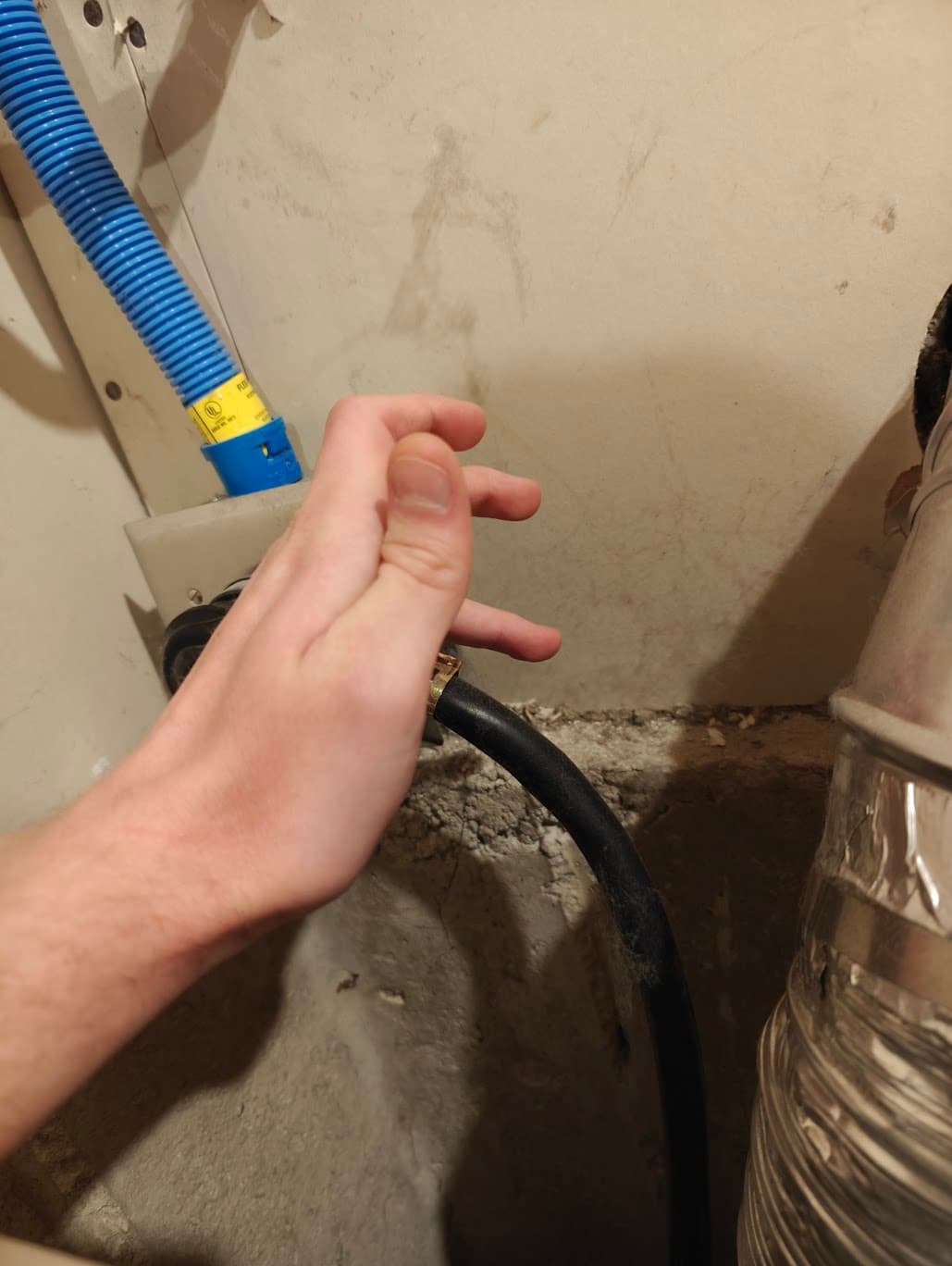

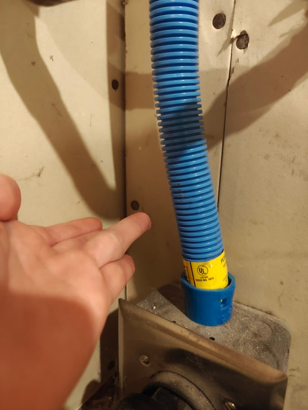

I also tested my dryer which is probably pulling about 4.5kW. The dryer cable itself I start to get feeling about 1-1.5 inch away, the 10 AWG Romex starts tingling my finger around 2-2.5 inches away.
