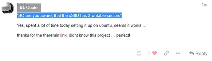

“SO are you aware, that the xSIID has 2 writable sectors”
Yes, spent a lot of time today setting it up on ubuntu, seems it works …

Forum tip, Highlight text and select the “quote” button :+1:
