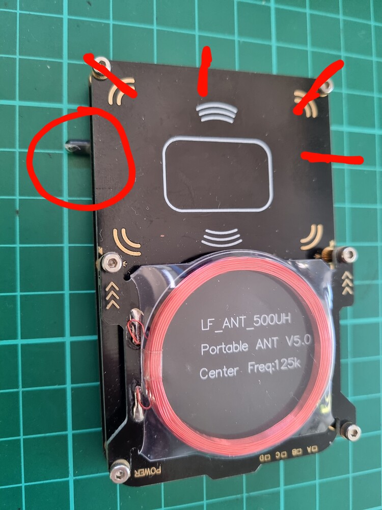

The HF antenna on the proxmark3 is on the bottom PCB, so your best shot at reading HF on an implant is to place the entire proxmark3 overtop of your implant. Make sure the antenna crosses the NExT perpendicularly. Also you might try using the delay command to ensure easy placement after pressing enter;
here are some pictures
View from the top, placement from below as seen from the circled xSeries
