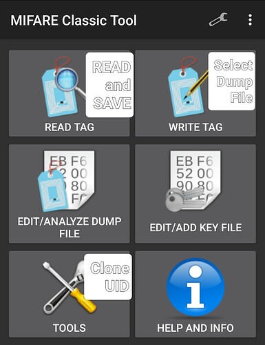

I personally use MCT for my gen2 reading and writing (Which I do reasonably frequently)
It has many useful functions, but the 3 I use the most
  • Clone UID
This might be all you need
Otherwise just
  • Read
  • Write
Should be pretty straight forward, but let me know if you need some more guidance
The Diff Tool can be useful also
