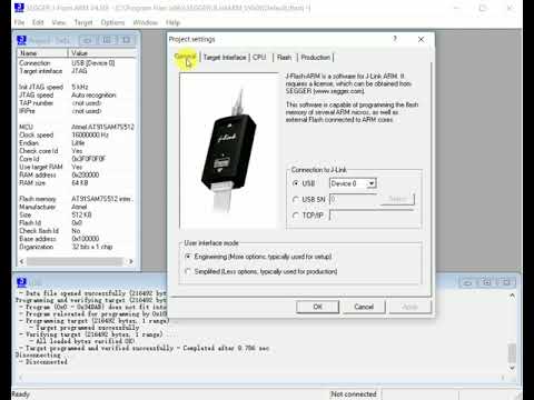

To me, from the look of your output, it seems the bootloader of your proxmark3 was actually updated… did it not take? This is all part of the pain in the ass we worked around for you with the proxmark3 on sale at
dngr.us/proxmark3
If the bootloader will not update over the wire, you might need to try JTAG programming…
http://www.proxmark.org/forum/viewtopic.php?id=5935
