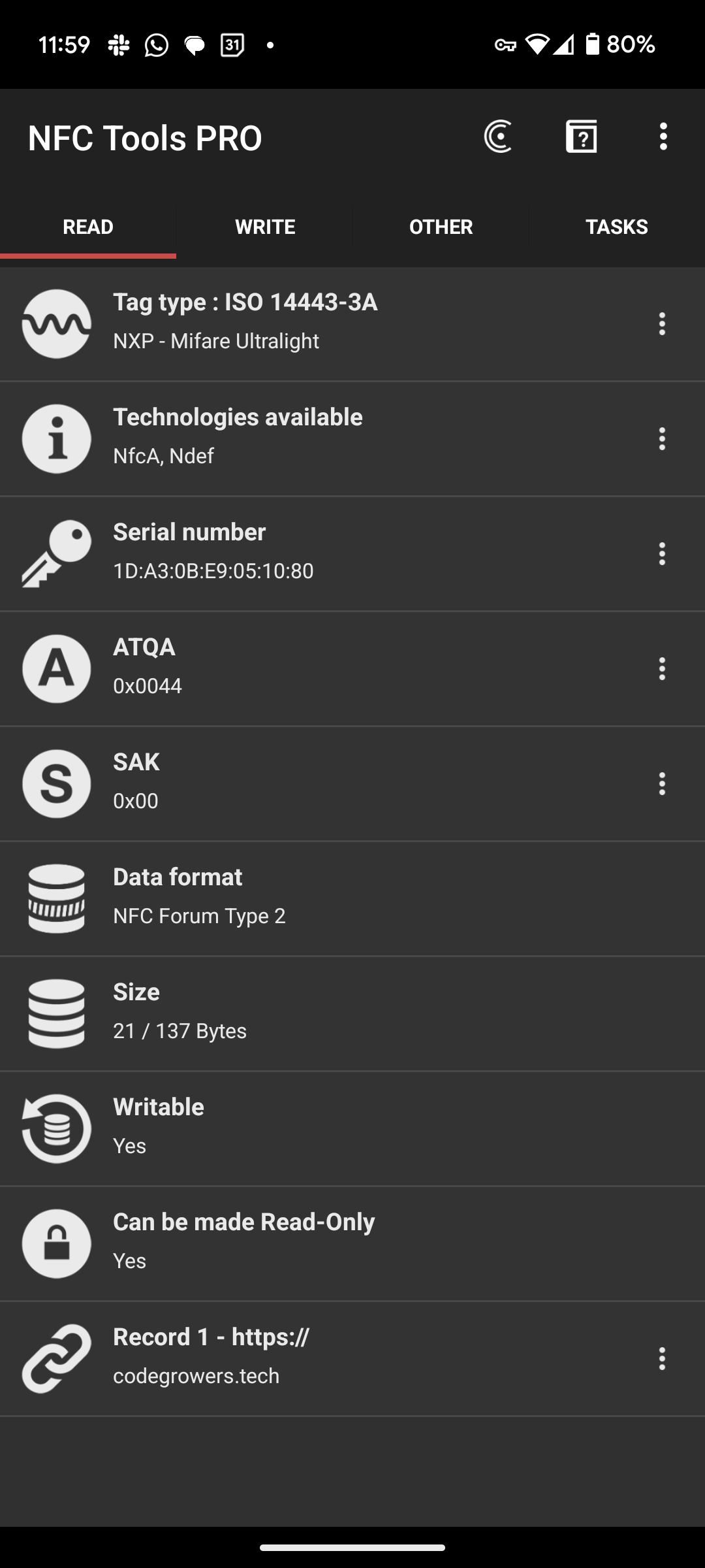

To be specific this is the tag I was trying to read with iPhone, without any app active, just trying to read the Ndef url.
This was captured easily with my Pixel 7 pro
