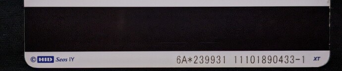

Hey guys, hope you guys are doing well. I’ve been trying to do a project of mine where I clone my student ID. Not specific to implants, just any type of cards in general.
I have included all the extra details in the files, but my university has these SEOS IY cards for student IDs, and I was wondering if Proxmark3 can be used to clone them? I saw a reddit post talking about a potential elite key, but I’m not sure if that’s also the case here.
Some of my observations:
  • The NFC Tag Info does not really show anything for the IC Info tab, but there may be some useful data in there otherwise.
  • When shining light through, the coil seems to be a large rectangular shape around the perimeter. I read here on a similar article that it may indicate a LF card, but again – not sure.
