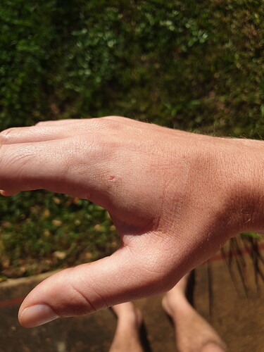

The key is in and the puncture has surprisingly knitted together over night and is barely visible. criticisms notwithstanding, this was probably the easiest install yet.

No, I actually installed bevel down. My previous install i went bevel up and it left a nice little smiley face scar. I’ve read that bevel down is usually recommended, but agree with amal that up is easier to control depth. I went bevel down this time to see if there is a difference. The puncture point from this insertion is barely visible after only 2 days so i think i’ll stick with down. Despite how I may appear in this video, I do take safety seriously and I’m not completely clueless about anatomy. I certainly do have a risk taking/thrill seeking personality but I think I have a good grasp of my own limitations (check out the other 2 vids on my channel
