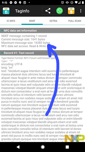

It took about 7 seconds to write on my Pixel 2 and about 6 seconds to read it all. Using FASTREAD command support this should be much shorter, but I realized from my previous discovery about how Android handles NFC data that the phone is basically trying to read the whole damn NDEF record BEFORE it passes NFC control to the app, which then reads the whole damn thing again. I have no idea why Android is doing this stupid crap but it does and there is no way around this… so basically reads will take twice as long as they should.
Shall I enable 32k NDEF containers? This is where things broke last time… but I feel like the P71 can handle it.
I believe that’s just the intent mechanism. I quickly looked at the relevant Android code a while ago, and it’s clear that normally, Android is supposed to get out of the way when the app in focus wants to deal with NFC all on its own. But I’m assuming there are certain types of NFC intents that can override the app in focus. So Android has to know what’s on the chip as well as the app. Possibly?
Either that or - more likely - whoever coded the NFC intent mechanism figured it was so quick he could leave the default code running all the time and nobody would notice

But my money goes to how the libs are structured, mostly around the checks done to detect the presence of NDEF capabilities. What some libs do is to attempt and read a message, if you can’t, then there isn’t. If you can, then you already have it read.
(the whole “better ask for forgiveness” mindset)
In some libs, such as nfcpy, you have direct calls for that, which work well since that’s the paradigm you want. so you only check for the presence if you want to read it.
Now applying Android logic, whenever anything within Android finds something new, it must consume it to check if anything else was expecting you to find it (hope my layman’s version of “Intent” wasn’t too confusing), but then if your application has not told the system it wanted that piece of information yet, then it gets discarded, and the only thing that gets through is “yes, there is an NDEF message”, which then your code will open (and read again)
