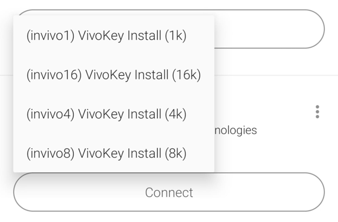

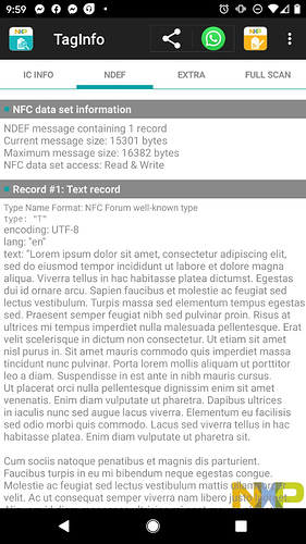

Just testing applet deployment to the Apex Flex prototype… the 16k NDEF container deploys like a dream.
Ok this time I pushed the limit on storage… I wrote 15k worth of data.
It took about 7 seconds to write on my Pixel 2 and about 6 seconds to read it all. Using FASTREAD command support this should be much shorter, but I realized from my previous discovery about how Android handles NFC data that the phone is basically trying to read the whole damn NDEF record BEFORE it passes NFC control to the app, which then reads the whole damn thing again. I have no idea why Android is doing this stupid crap but it does and there is no way around this… so basically reads will take twice as long as they should.
Shall I enable 32k NDEF containers? This is where things broke last time… but I feel like the P71 can handle it.
Please!
No answer yet… bricked?
Could they be user choosable different applets to choose from in the final product?
4k
8k
16k
32k
There are, implemented as different services in the fidesmo applet.
I believe that’s just the intent mechanism. I quickly looked at the relevant Android code a while ago, and it’s clear that normally, Android is supposed to get out of the way when the app in focus wants to deal with NFC all on its own. But I’m assuming there are certain types of NFC intents that can override the app in focus. So Android has to know what’s on the chip as well as the app. Possibly?
Either that or - more likely - whoever coded the NFC intent mechanism figured it was so quick he could leave the default code running all the time and nobody would notice ![]()
