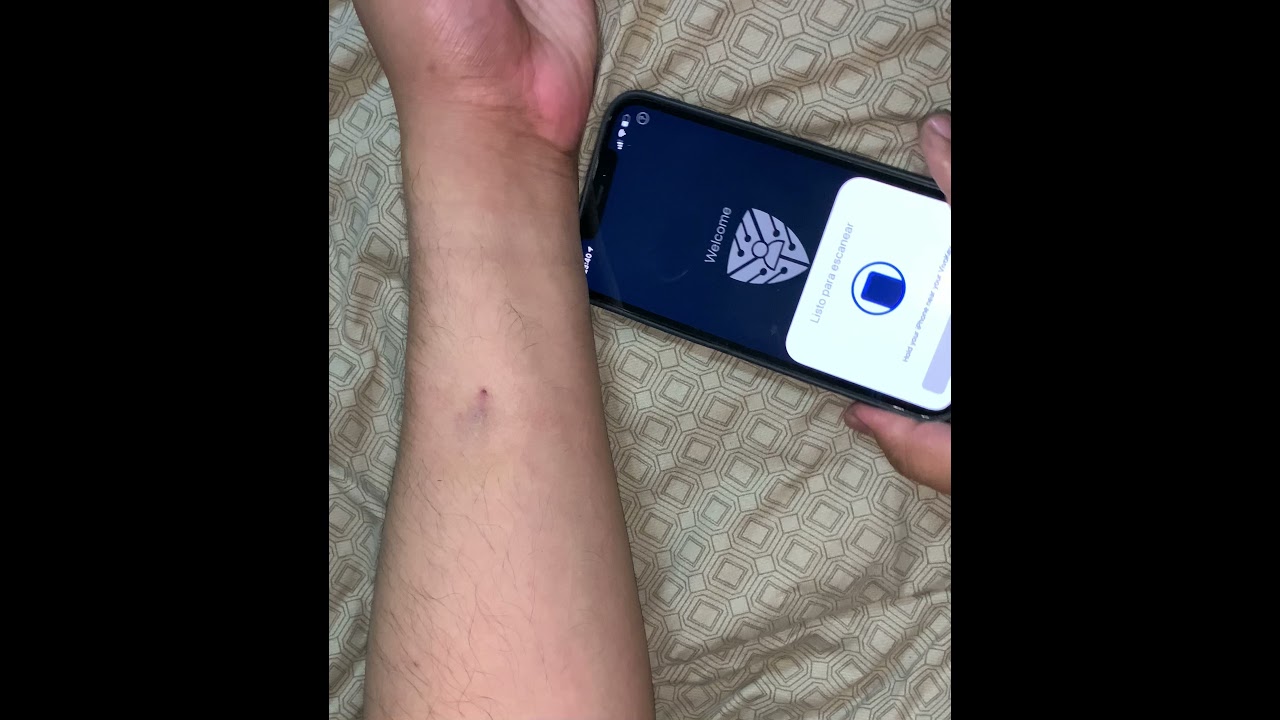

Some time has now passed. The Spark 2 cannot be scanned with the Vivokey app. Sometimes I come into contact with the NFC tools and the NFC TagInfo app. But this is also very irregular. What else should I do more? I feel same like, somebody left me in the rain.
Can you post a video of your scan attempts? Mark the spark location and direction on your skin first so the line represents the spark under the skin… then present your phone. I know it might be hard to video it if your phone is your only video device but maybe as someone else to and send it to you?
