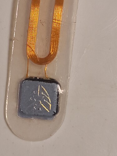

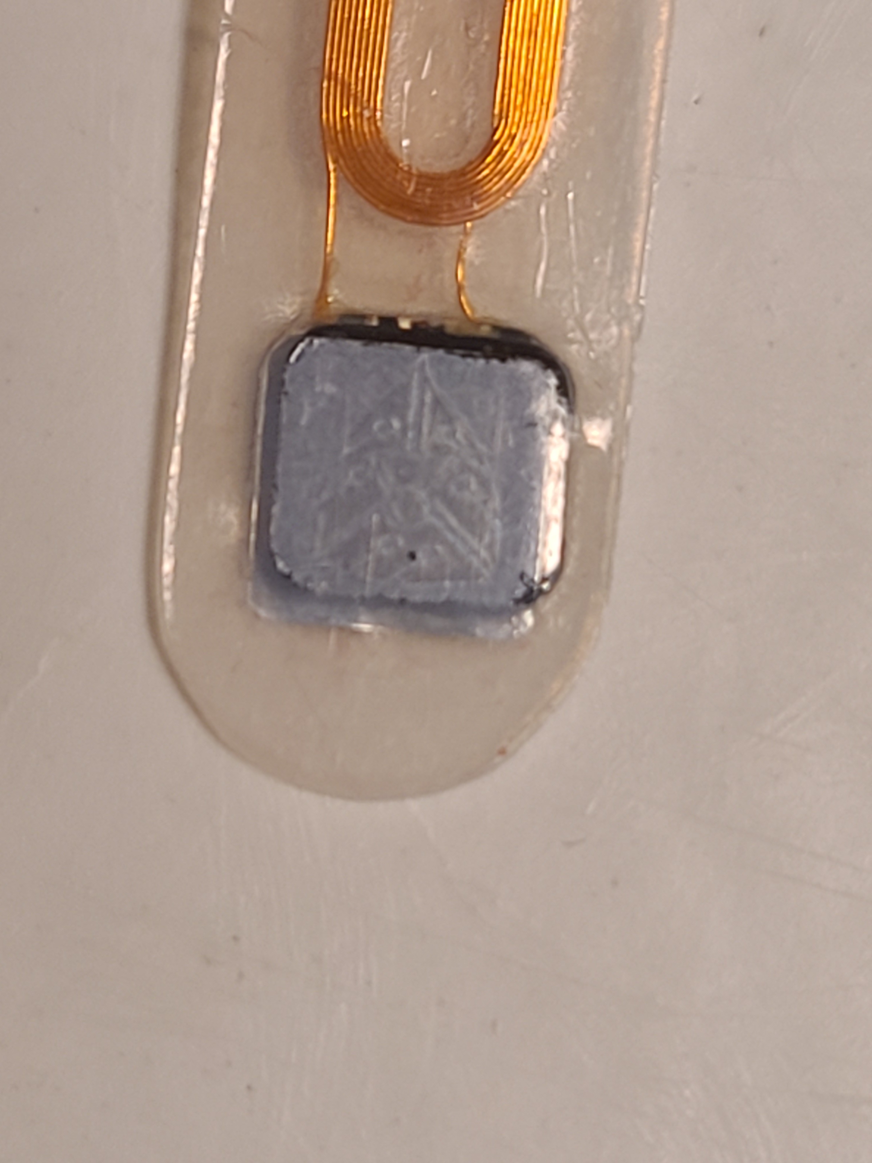

That’s an awesome offer, but I don’t think it’s necessary unless you just want to.  I had it dug out, and even out of my arm, nothing. The leads look good even under a magnifier, I can upload a couple of pictures if you want. (I’m happy to send back regardless). If I had a choice? Bump me to the top of the new list for Vivokey!

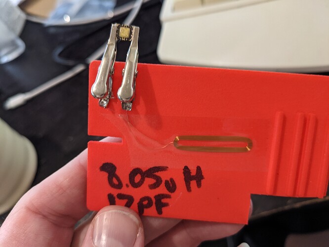

This is another chip extracted from a flex one prototype that is now using a borrowed antenna hah! I honestly use this almost daily because I’ve still not transitioned to an apex yet myself… waiting on that mega goodness.

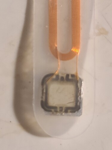

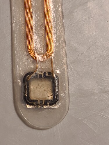

let’s see the other side of that chip where the wires bond to it?
Hmm hard to tell what the issue actually is but my guess would be a wire connection problem of some kind.
If you want to ship it back to me I can tinker it to see if we can bring it back to life… at least to make otp codes easier to access and swap to a new device.
Oh yeah, these coils you make are great! Turns out I still have one somewhere from an old project.
