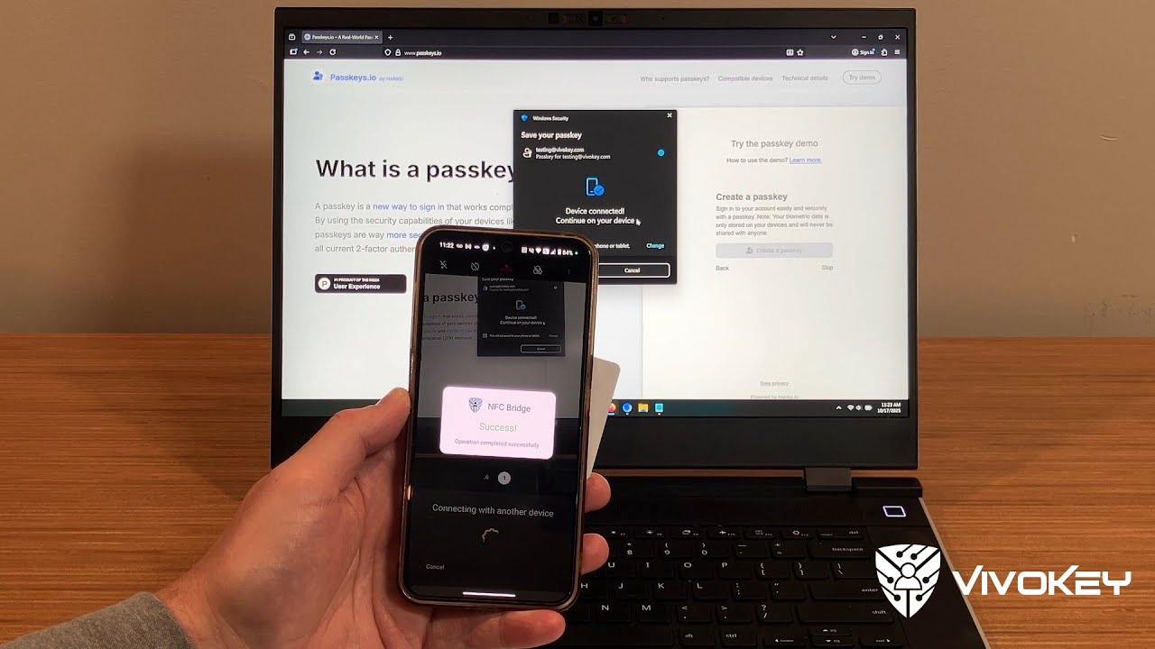

Want to use your NFC passkey token with your laptop but don’t have an NFC reader, or just don’t want to lug one around with you when you have a perfectly good (Android) phone with NFC in it? You need VivoKey NFC Passkey Bridge!

Observation 1:
Windows 10 + Firefox + passkeys.io: Firefox does not prompt to use another device. It defers the request to Windows Security, which only has a prompt for using the key directly on the desktop.
Windows 10 + Chrome + passkeys.io does provide the cell/QR code option, but….
Observation #2: Initial attempt to enroll a passkey onto open-source FIDO2 applet on a P71 test card does not work unless a pin has already been set (via desktop + USB NFC reader).
Windows 10 + Chrome + passkeys.io + Samsung S24 + Android 15

  • passkeys.io → create account → enter email → Create a passkey
  • Chrome prompts with “Choose where to save your passkey”, select “Use Phone” → QR Code
  • Scan QR Code with phone → Bluetooth connection established –> Passkey provider selection
  • Change provider to the NFC Bridge
  • Prompted to tap the NFC passkey → hold P71 to phone
  • Prompted “Enter PIN”
  • input new pin → ok
  • Error: CTAP error: PIN_NOT_SET
Desktop:
If I repeat the same process, but select to use “Windows Hello or external security key”, click through the consent screens, I’m prompted to scan my NFC card and create a PIN. Scanning via an ACR USB reader works, the PIN gets set, and the passkey.io credential is created and stored.
NFC Bridge #2:
After I have a PIN created, I can now use the mobile/QR/NFC Bridge option to successfully:
  • authenticate to passkeys.io via passwordless login using a PIN
  • enroll a new credential (different email with passkeys.io) using the same PIN
So it is only the setting of the initial PIN that doesn’t seem to work via the NFC Bridge app.

Great observations and perfect level of detail reporting issues.

Yes this issue has more to do with Windows 10 than anything. Updated FIDO2 CTAP2.x support was not well established in the OS so browsers are sometimes required to do some of the heavy lifting.. and well, Firefox just isn’t on Win 10.
An oversight. Update in the works.

It’s my understanding that on Win 11 pretty much all browsers hand FIDO over to the Windows OS completely, and Win 11 has more robust FIDO CTAP handling, and follows the CTAP2.2 which is where the caBLE protocol that handles “the qr code stuff” for passkeys is defined. Since Win 10 doesn’t get updates anymore and does not support CTAP2.2, I think Chrome realizes this limitation and takes matters into it’s own hands.. while Firefox does not do this and just hands everything over to Win 10, which is why this feature seems lacking when using Firefox on Win 10.
App update to handle this should be available later tonight. Not sure how quickly Google will approve but it’s an incremental update.

New version (1.0.5) submitted to Google for review that supports PIN SET. Also updated some small UI elements to improve process transparency.
