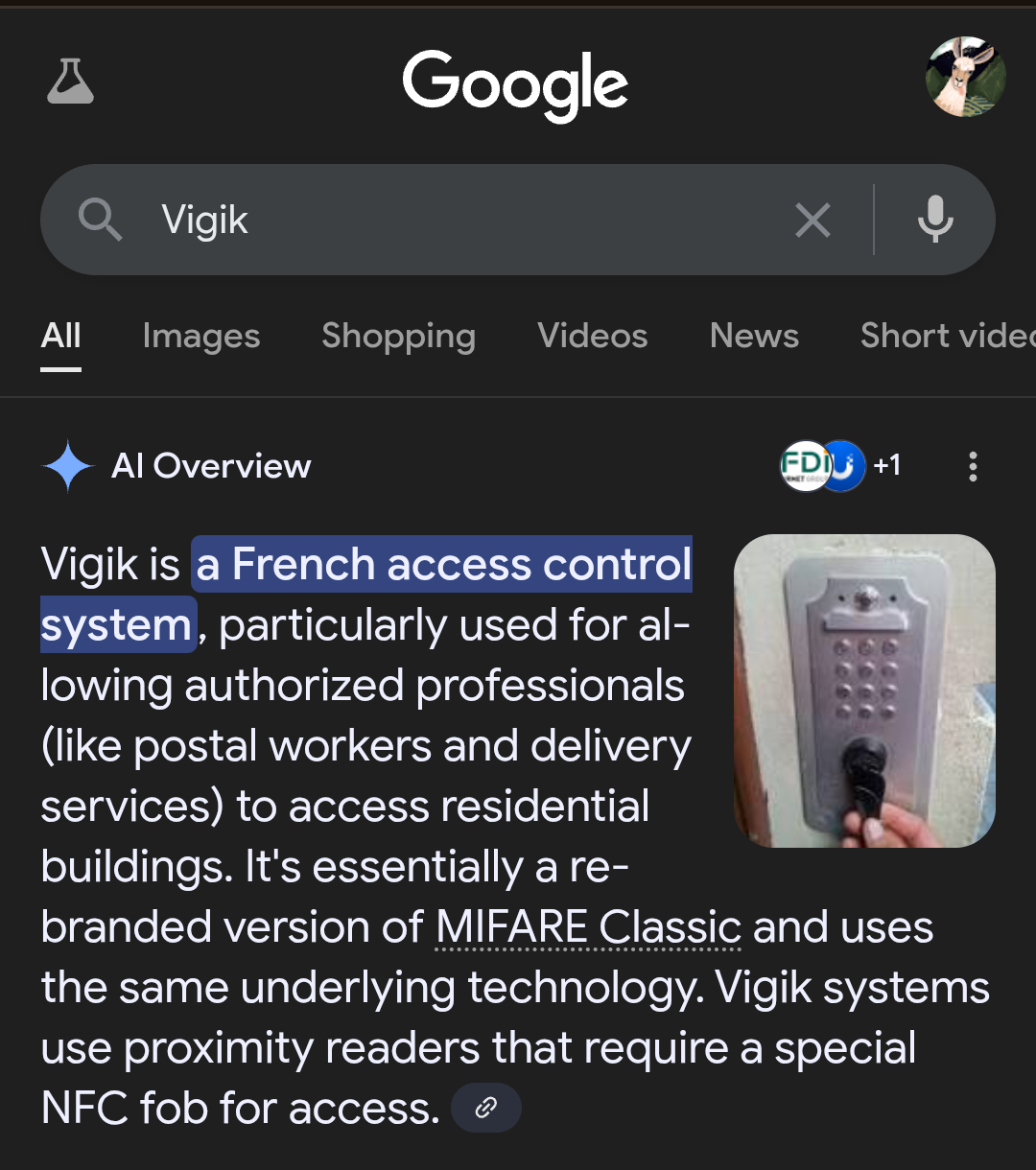

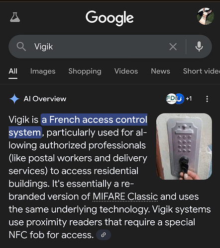

If AI can be believed…

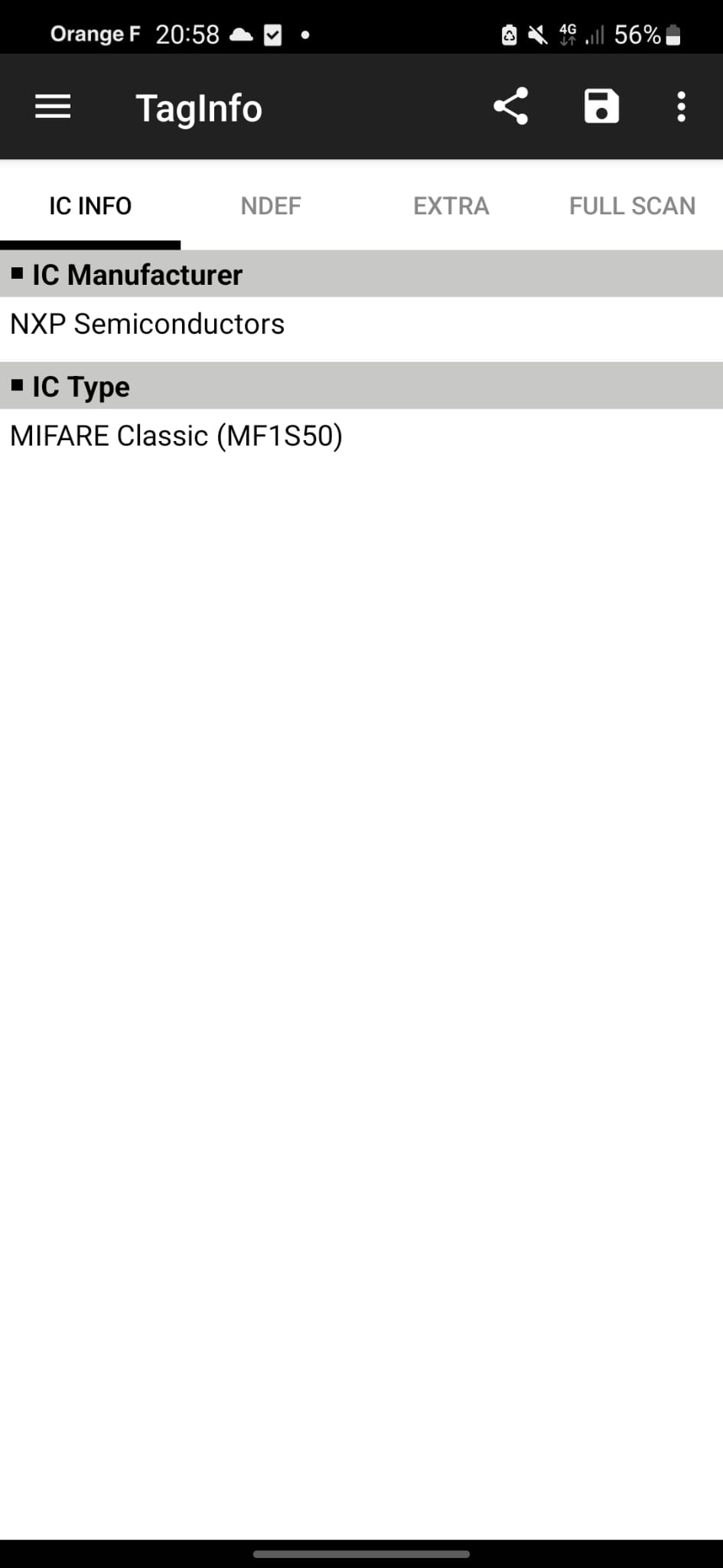

Based on this you’d need an xMagic implant. Before buying though be sure to scan your real key fob using taginfo and post a screenshot of the Full Scan tab.

According to Google, the Vigik system uses “Mifare Classic” chips. In the world of ISO14443A compliant RFID / NFC chips, there are several different types of chips. They all speak ISO14443A but the features they have, memory structures, and basically how they work is all different.
The xMagic contains a “magic mifare” chip that emulates a “Mifare Classic” chip. This has a 4 byte NUID (non-unique ID) and memory arranged in 16 byte sectors, with each sector protected by an access bit and key block. The NExT contains an NTAG216 chip with 7 byte UID (unique ID) and memory arranged in 4-byte pages. The way they work is fundamentally different. You will need an xMagic.
Once we confirm with your Andorid phone that your Vigik key fob / card is really a Mifare Classic style chip, we can proceed with xMagic selection (there are two types, gen1a and gen2).

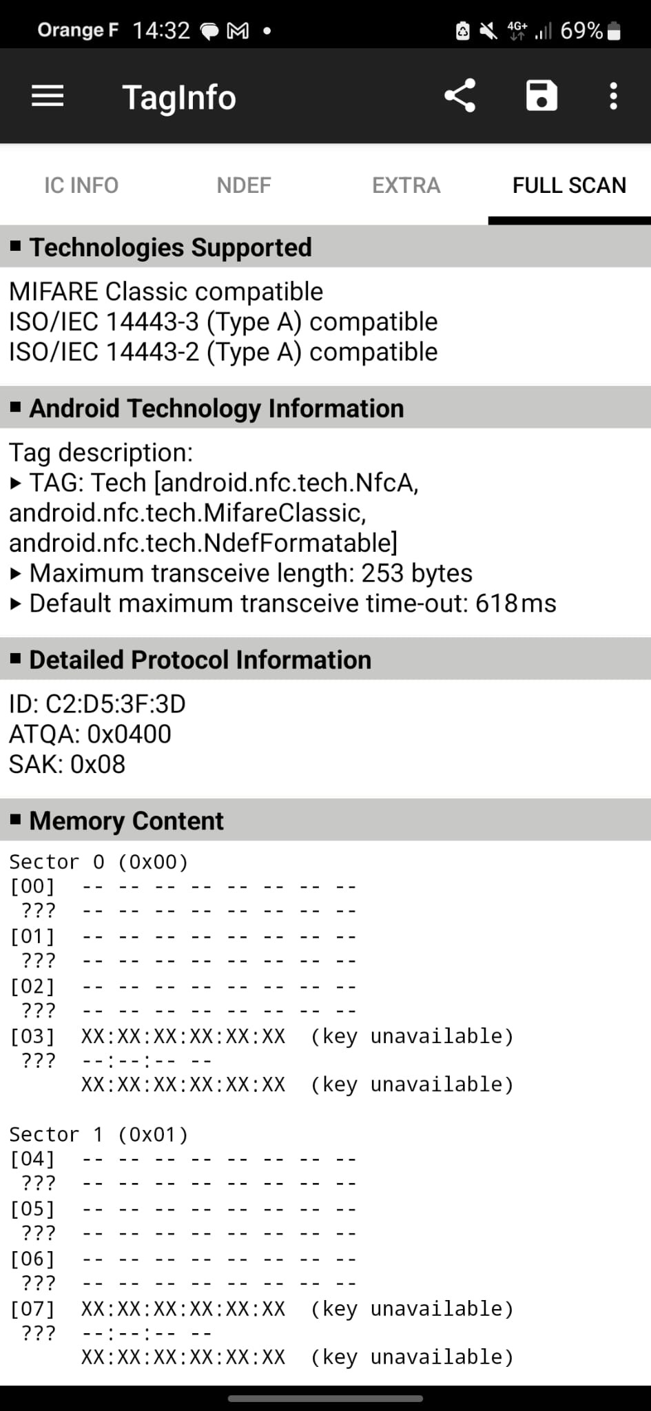

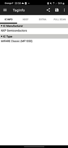

Hi again,
Here is the TagInfo screenshot as promised!
I also took the time to do a deeper scan using Mifare Classic Tool app and I can confirm that I’m able to read the tag properly. However, as you mentioned earlier, I can’t clone or write this kind of data to the VivoKey Spark 2 — so you were absolutely right.

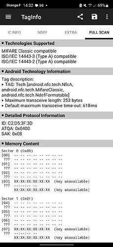

Can show the “Full Scan” tab or at least confirm the ID is 4 hexadecimal bytes and not 7 bytes? The ID would look something like “ID: A4:E8:73:18” as the hex bytes are represented as alphanumeric codes 0-9 and A-F so like a single byte in hex is something like 8F or 31 or 01 or FF or AA… and bytes are separated by colons like 03:F1:8A:DE

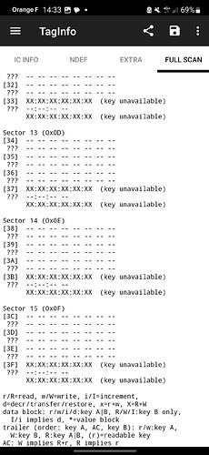

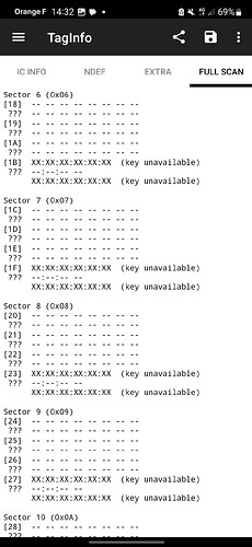

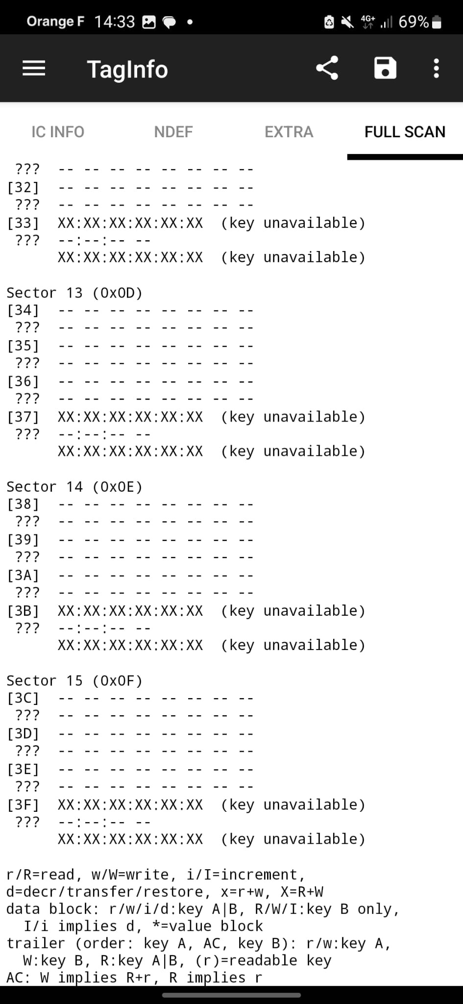

Ah sorry — I totally forgot it had to be the Full Scan tab specifically!
Here it is now.
Thanks again for your patience!
Best,
Jimmy

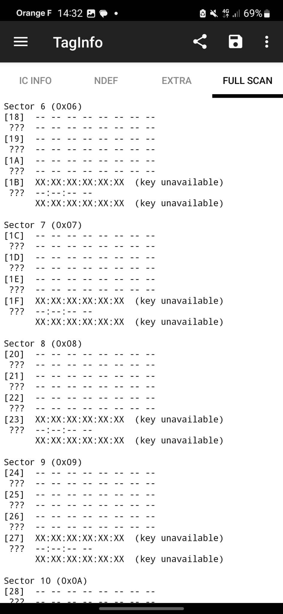

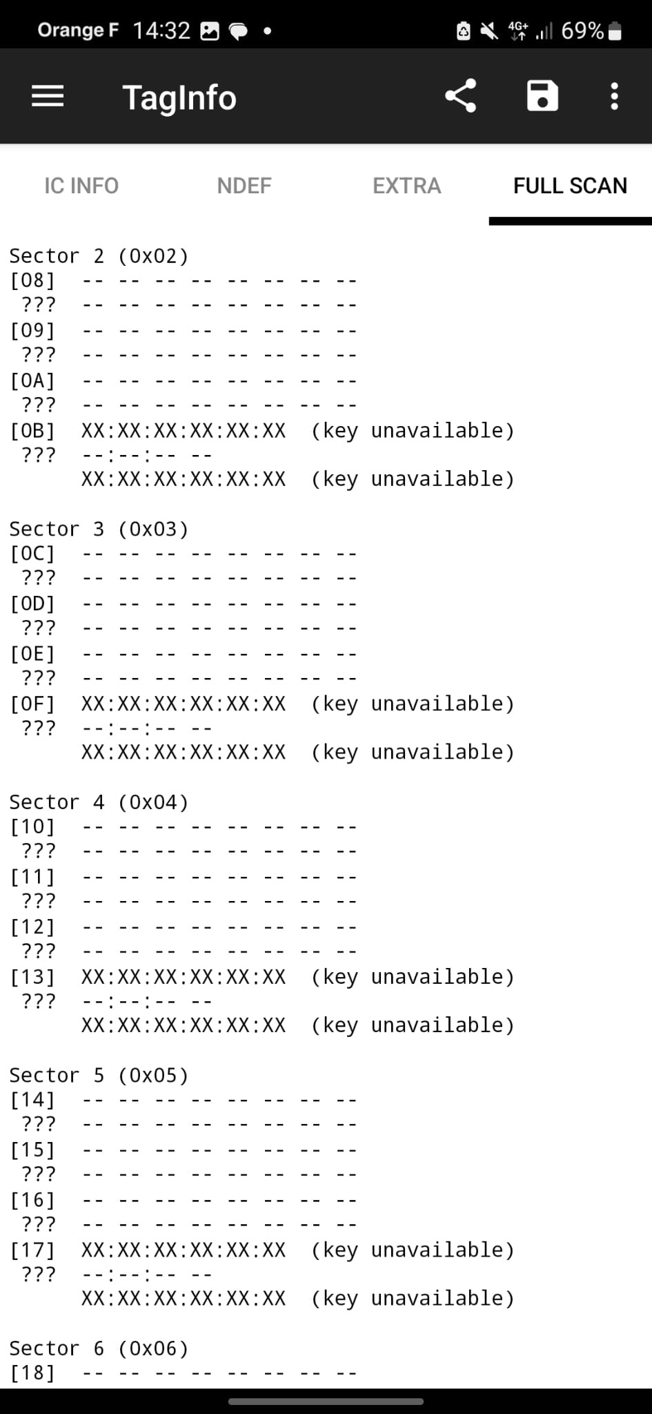

Ok… next challenge… see all those XX… that means the sectors are secured. Luckily the old mifare classic chips are vulnerable to attacking and breaking that security using tools like the proxmark3.
Next step is to buy a proxmark3 to see if you can crack that card and get they keys and memory contents. Without doing that, am xMagic will be useless basically.

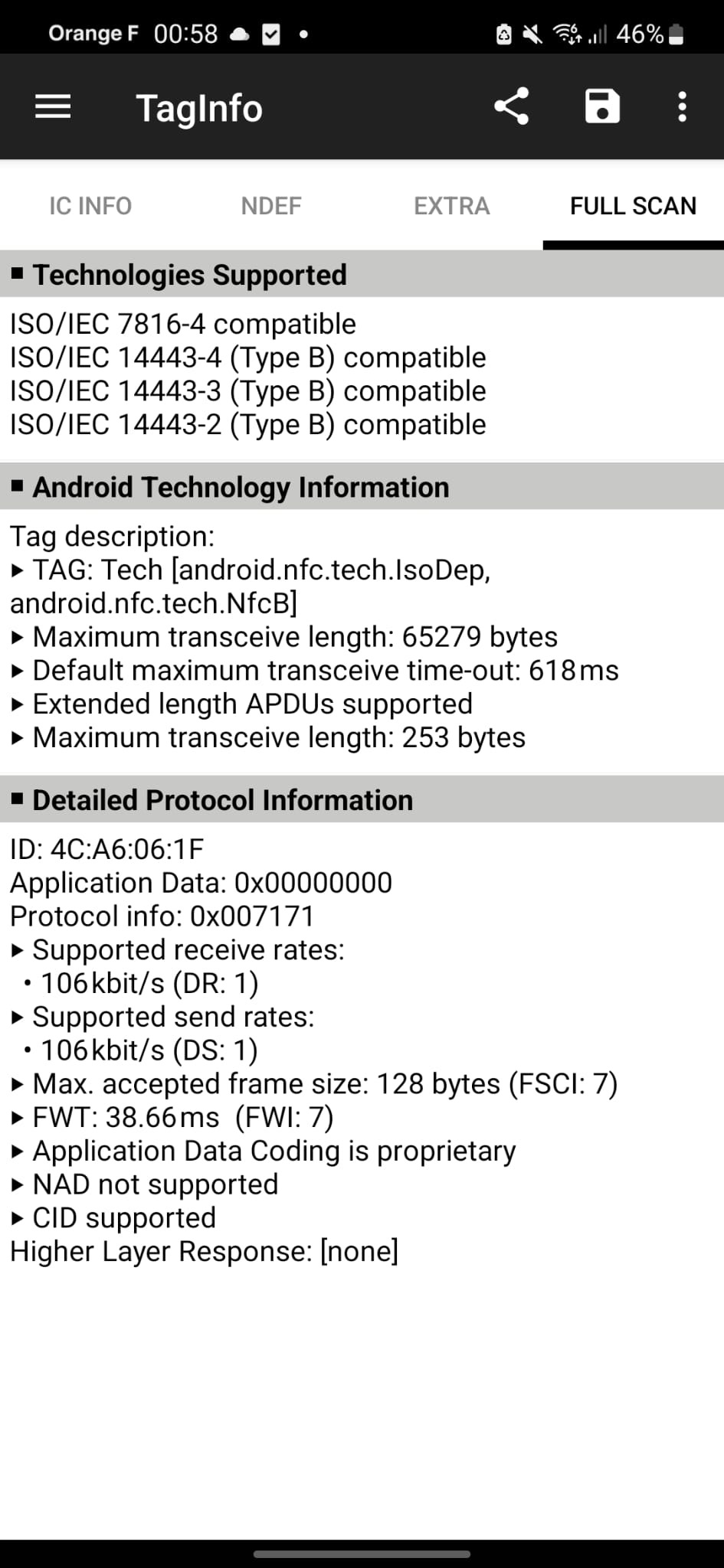

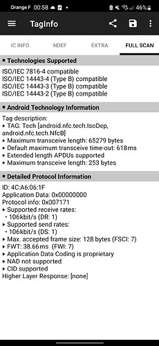

Hey again!
Here’s the full TagInfo scan of my Navigo card as promised — let me know if there’s any chance of making it work, or if the conversion service might be the only path.

That makes sense now — I did notice all the XX in the scan and figured it wasn’t going to be that simple.
I’ve read a bit about Proxmark3 attacks on MIFARE Classic cards, but I’ll be honest… I’m not exactly a hacking genius :sweat_smile:
Do you think it’s manageable for someone who’s new to this, as long as I follow tutorials carefully? Or is it really something that requires deeper programming or command line experience?
I’m definitely motivated to learn — I just want to make sure I’m not getting in way over my head with the Proxmark3.

It’s a an ISO14443B card… rare. Conversion may be possible… can you post screenshots of the other tabs, or just tap the share icon and post the full scan txt or xml file it saves?

I think it’s something that can be tried… if you grab a proxmark3 and want to give it a go, we’re here to help… this thread can serve as that mechanism.
