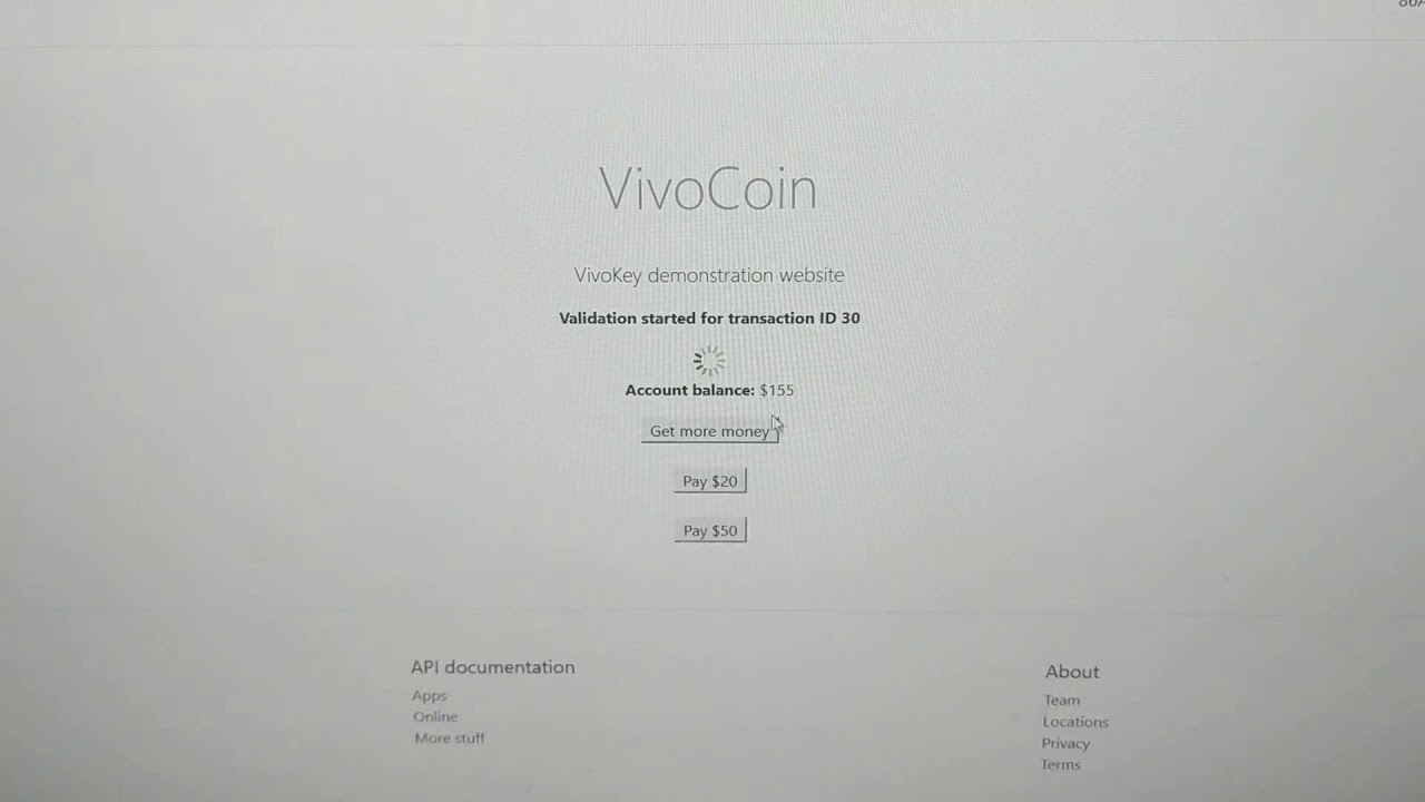

Not natively on chip, but we may have a platform version of such. For instance, when you say “2fa” that is very generic… our validation API is exactly meant for this kind of two-factor, but it is not the “OATH / OTP” version you may be thinking. Here is an example video showing our pre-release API doing 2fa for authentication using OAuth2, as well as a transaction authorization using the validation API.
More features will be added to the platform in the future, so the Spark will be useful for API integration as shown above, but we also plan on using as a security mechanism for future VivoKey services. That also includes accessory hardware we are also working on.

Im Impressed by the speed of the validation test in the vivocoin demo :slight_smile:
Wondering though, vivocoin? :slight_smile: real plan on a future cryptocoin launch by DT? or just demo?
#14
Just a demo… we have no value add for a real vivocoin… at least not yet anyway.
#15
Ok, then I know, thanks for clarifying :slight_smile:
