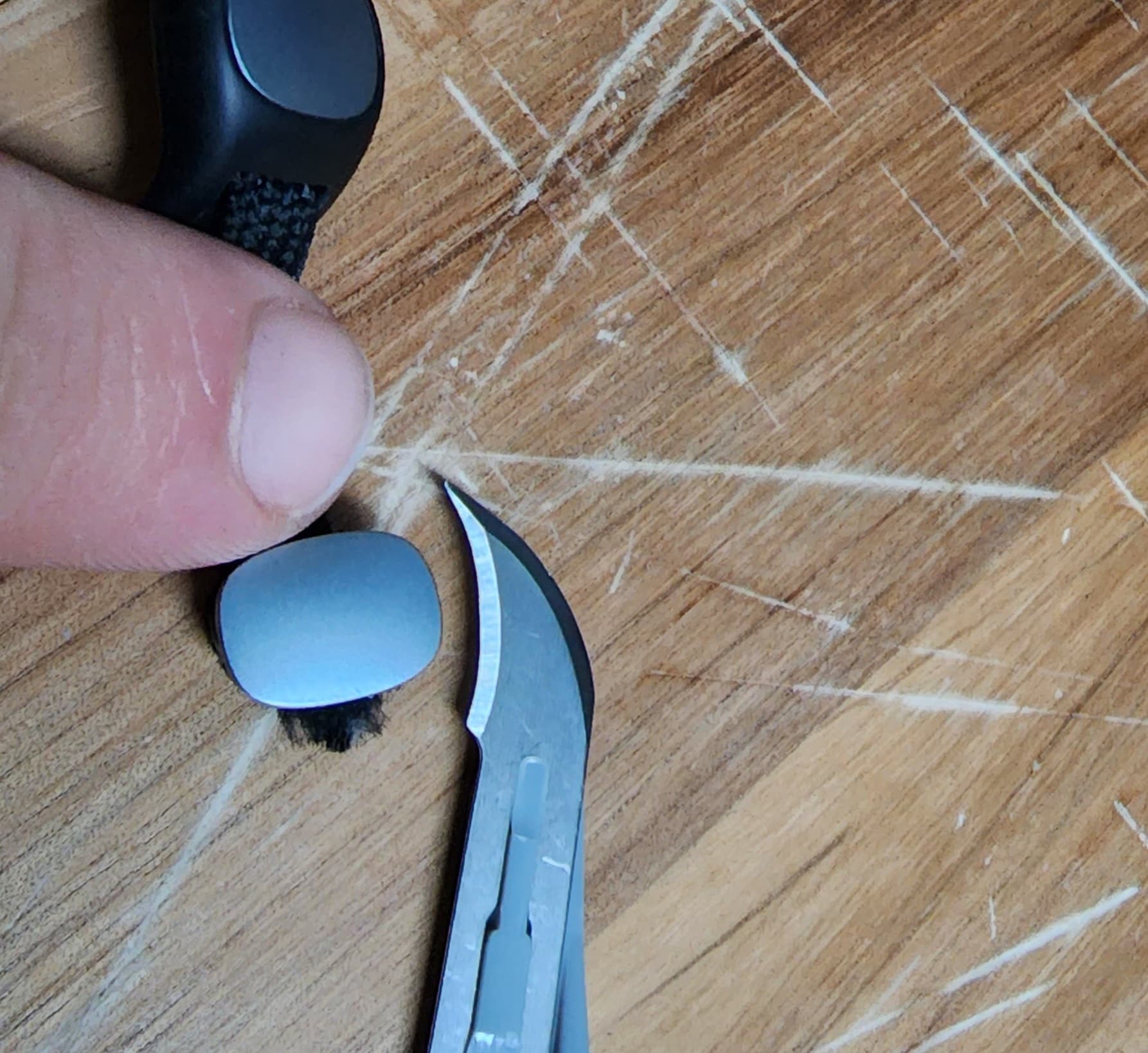

So I am breaking down my Tap Strap 2 and want to add a magnet to the first length of each finger to hold it on instead of using rings. I cut off most the excess rubber just to get an idea and all 4 fingers are 5.540 g together. They probably weigh about the same so say I need to hold at least 1.38g per finger BUT have some resistance to acceleration and deceleration and some room for normal daily movements. The thumb part is staying a ring so it can’t wholly come off ever and because it’s the heaviest part.

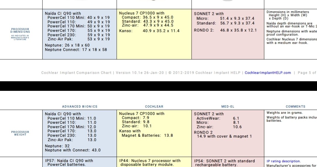

If I use Cochlear implants as a large sample size for long duration wear of magnetic devices (average wear time for the processor is 10 hours a day and it’s attached magnetically). I could probably rough out some math on the weight and surface area of them. But there has to be an amount of pressure that isn’t a problem. I’d think issues wouldn’t occur if the skin isn’t deforming as a high level test.
Just using this place to save my preliminary data screenshots. I need to get info on the size of the magnets/contact area… But not tonight.
For the cochlear implant not only is the pressure spread out over a much greater area because of the ring, but the strength of the magnet is greatly reduced because the plastic holds it away from the body. The internal mounting magnet is also screwed into bone to prevent it from crushing the skin from the inside.
So the ring is larger but I don’t have anything saying all models use the whole ring for the magnetic parts. The circle itself is probably an antenna. But I’d have to look at actual tear downs of it. My point is that as a blanket statement it’s not necessarily true and there is some combination of weight/surface area that doesn’t cause issues.
If I can get these out of the rubber housing that remains they’ll be even lighter and I think it can be done.
The magnet is in the center elevated a few millimeters above the flesh, and yeah the ring contains the coil.

I also have to get them out of their cases and get a final weight. Weighing them is hard because of the cord between them and trying to exclude the larger thumb piece.

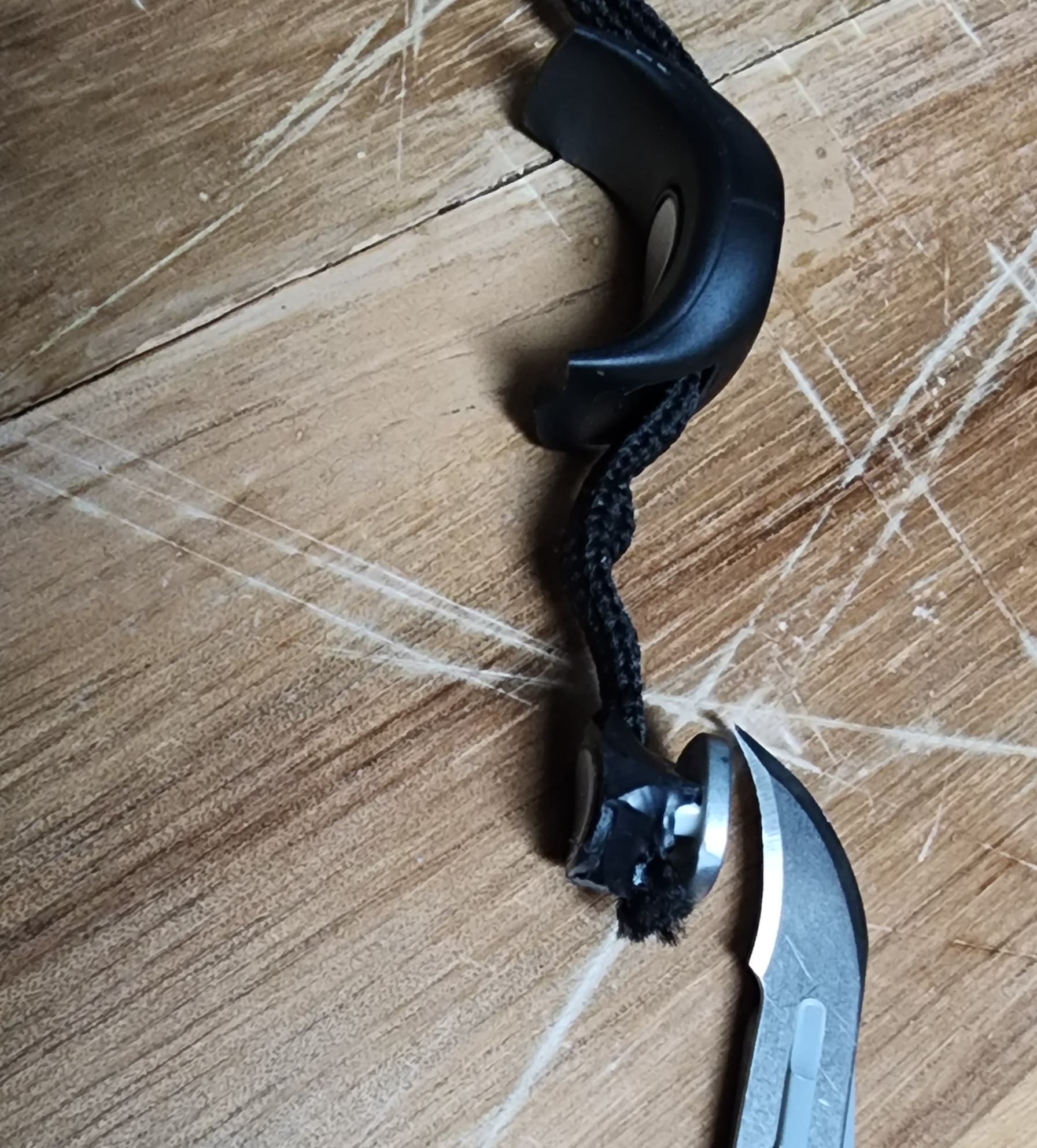

That said since I’m apparently not going to bed like I said I would I decided to see just how much of each finger piece is rubber. I got the pinky stripped down (and it still works even if it doesn’t work well since it won’t stay on). I got .86g of rubber off of it. The others probably have slightly more since they’re for the larger fingers.
That shows the side and the top. The bottom is just the top but slightly smaller. Probably for a final useable one I’d add some rubber back to the sides and bottom so it’s less tall.
Except for being the magnet where it sits into the case, I don’t know how much the bottom does function wise. If I find a broken one on Mercari or one someone just wants rid of I’ll get it and properly destroy it.
