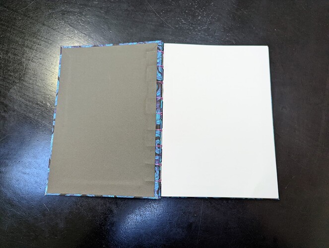

While not typical “maker” stuff, over the last few months I’ve gotten into bookbinding. I’m working on a longer term project that’s a leather bound version of Dracula and while I’m waiting on tools or supplies I’m making quicker journals.
Here’s the progress on Dracula:
Here are the journals I’ve made:
This is a Japanese Stab Binding
The last two are called a Secret Belgian Binding or a Criss Cross Binding. For these I actually made my own bookcloth.
That’s crazy cool
