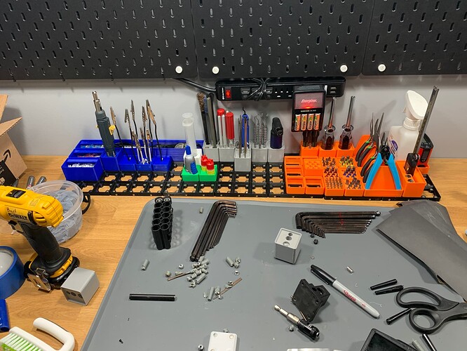

You’re set up is coming together, looking nice!
Bites and nibbles I think I forgot to take pics of 3-5 additions
The nice thing about the system being modular, it removes a LOT of the analysis paralysis
All of these tools I use at one point or another…
I don’t have to worry about the “perfect” layout because I can change it on the fly to adjust for whatever project or shenanigan I’m up to
If it’s not clear, I’m using a basic color scheme for the pieces
Black will always be bottom grids
White is currently part storage… I’m not married to it
Green will be adhesive/attachment
Blue is electrical
Orange is tools…maybe dremel stuff…
Grey is detail or post processing
Admin/writing marking/ parts baggies will possibly be red
I forget who accused my desk of looking too clean…
it just cleans up quickly lol
