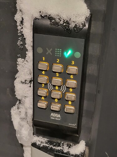

Hi. i see there are mant diffrent implant. would like something that work for my door at work, and one that works like mt bank card, guess i need two then? i took pictures of the reader at work. and i use a keychane thing for the reader.

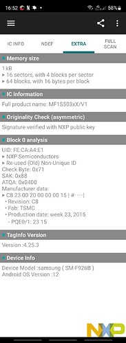

That ASSA Pando Secure reader looks identical to the Axis A4011-E. And it supports several types of high frequency chips. So try scanning your card or fob with your phone and NFC TagInfo, this should give you an idea of the credentials that the system is using.
Well, good news, It looks very much like a Mifare 1k implant would be compatiable for your work reader.

How I came to this conclusion:-
From your scan, the indicators are
FE:CA:A4:E1 ( 4 Byte ID )
MF (Mifare)
1 (1k)
S50 (the chip type)
Re-Used (old) Non-Unique ID (pretty much the definition of this chip)

For your particular reader, I see the “RF” antenna symbol is in the middle of the keypad. With a full sized card, you could probably just slap it anywhere on the reader and it will probably just read and work. The antenna is actually more likely to be around the perimeter but that is not a certainty; also with protruding buttons you may not be able to get your xM1 close enough to the reader to couple reliably…if at all.
Whereas a FlexM1 would give you a better chance of getting a read.
