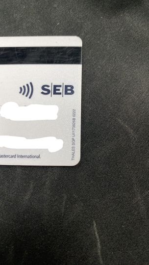

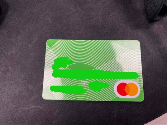

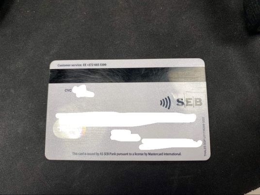

Can you take a photo of your card (Hiding your personal information obviously)
Also a link to your Bank maybe helpful
https://sebgroup.com/

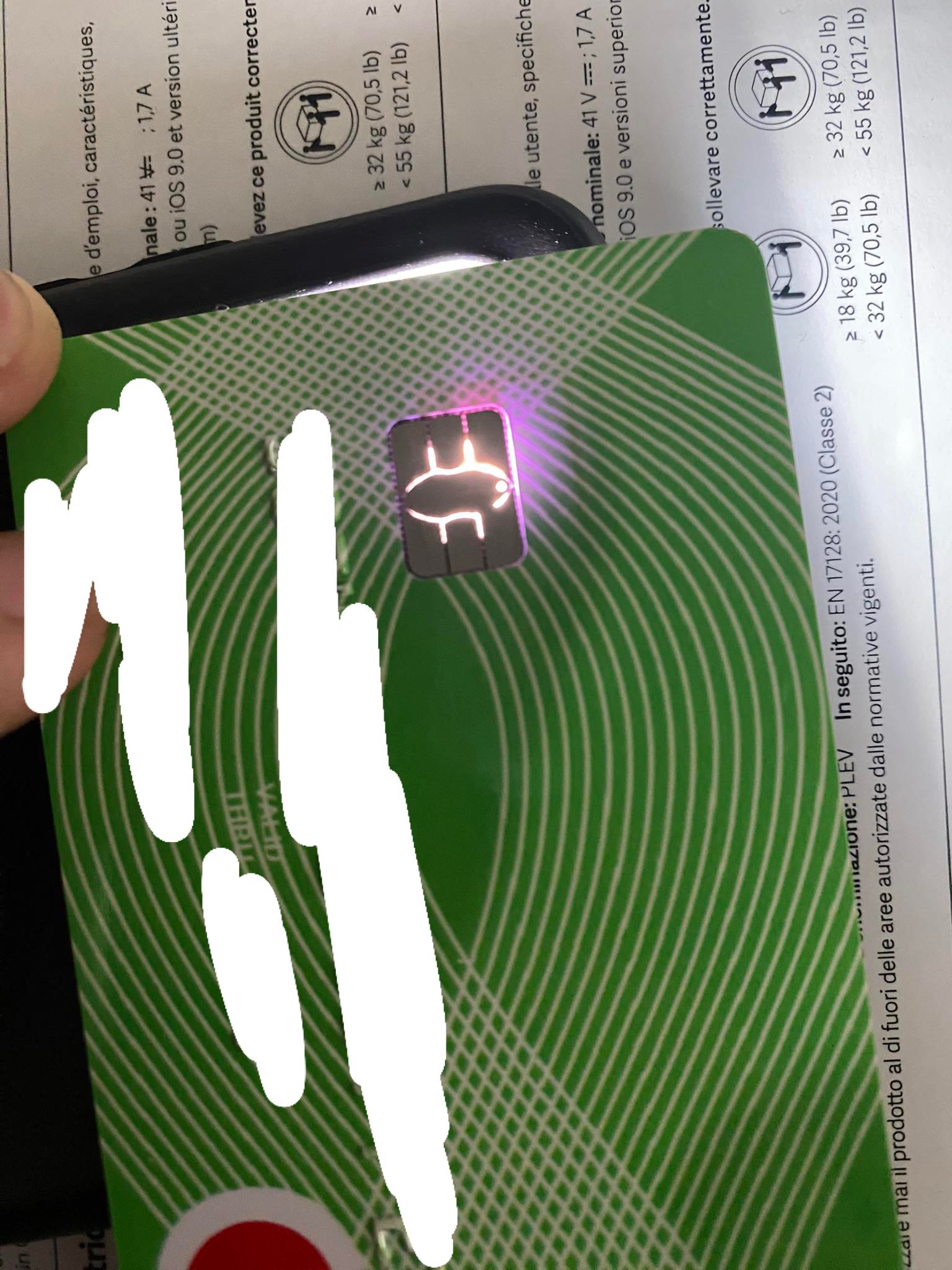

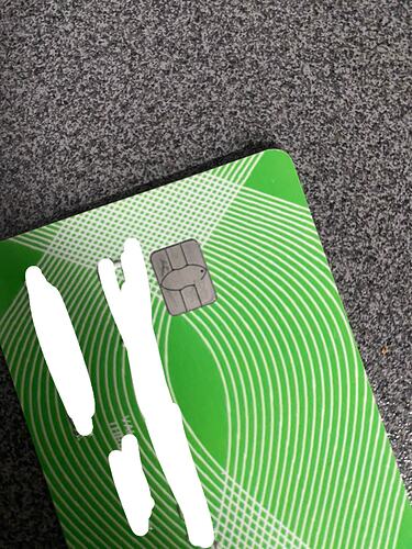

Can you shine a bright light through the back and take a picture of the chip and the general shape of the antenna?
You can’t see that good, but if it helps I can draw it and send it.

Alternatively, the new CoM conversion could be a suitable option for you, but you’ll need to share a photo of the chip on your card to know if it is viable.
Can you also yse a very bright torch to illuminate the internal chip of the card, like this

I don’t have a light that is as bright to see all the card because my card is with weird design that you can’t really see through it even with light, I can make a video of showing the antennas, because I can follow the antenna with my flashlight and then you can see what’s going on there, because I can’t show the whole card at once and I don’t have such a bright light for it. As I said I can draw what I saw inside the card.
Do you wanna see like the main chip with flashlight? Does it help you in anyway?
Hmmm, ok, I dont think the CoM chip is viable, but ill let @Satur9 confirm that.
The other chip was quite difficult to see whats going on, unless you can get better lighting and
If that was the path you wanted to go down, Could you download TagInfo and share the following acter scanning the hidden chips antenna

I’m pretty confident that’s not a CoM chip, and they’ve only shown us one card
Ahhhh, yes, right you are.
