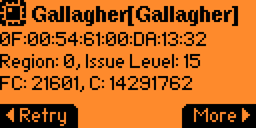

Nice one, I’m not sure if you have played with Gallagher before on the PM3
Nothing different, and you won’t need a hand, But just to save you some time ( it should only be 2 commands “reader” & “Clone”
lf gallagher reader
Then Raw output into clone command, and most likely it will just be the top line required (That will include the facility code and Card number within the raw data)
lf gallagher clone --raw 0FFD5461A9DA1346B2D1AC32 → encode for T55x7 tag
lf gallagher clone --raw 0FFD5461A9DA1346B2D1AC32 --q5      -> encode for Q5/T5555 tag
lf gallagher clone --raw 0FFD5461A9DA1346B2D1AC32 --em      -> encode for EM4305/4469
lf gallagher clone --rc 0 --fc 9876 --cn 1234 --il 1        -> encode for T55x7 tag from decoded data
THAT SHOULD BE DONE

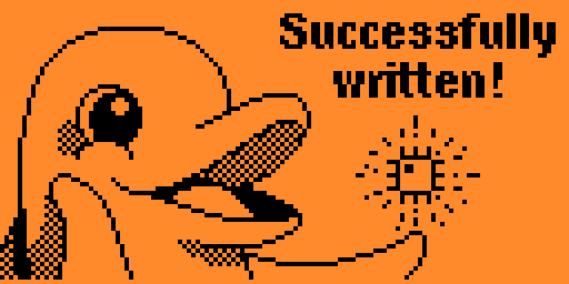

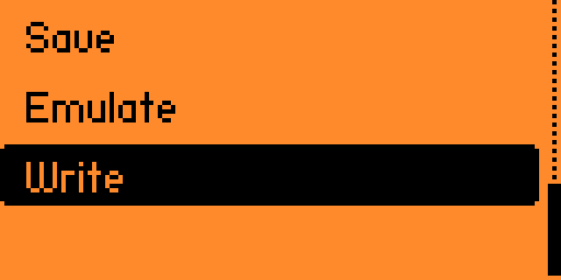

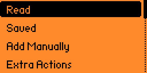

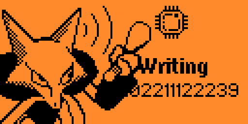

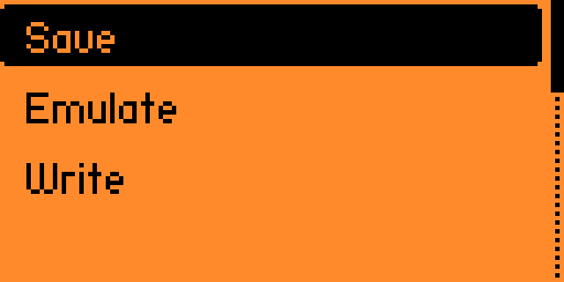

We all know how tricky the PM3 LF antenna can be to couple, so,
If you have a Flipper, that works far more easily
:flipperzero_white:
I actually have both an RDV4 and a flipper, So covered either way! Thanks again Pilgrim!
