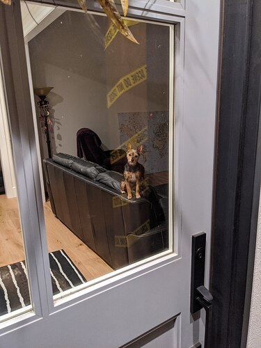

I’ve been looking through the Show off USING your implant! thread and I’m looking for recommendations for door locks. I’m in the US and the part of my door where the lock would be installed in rather thin. You can see it in this picture of my dog totally betraying me when I locked myself out.

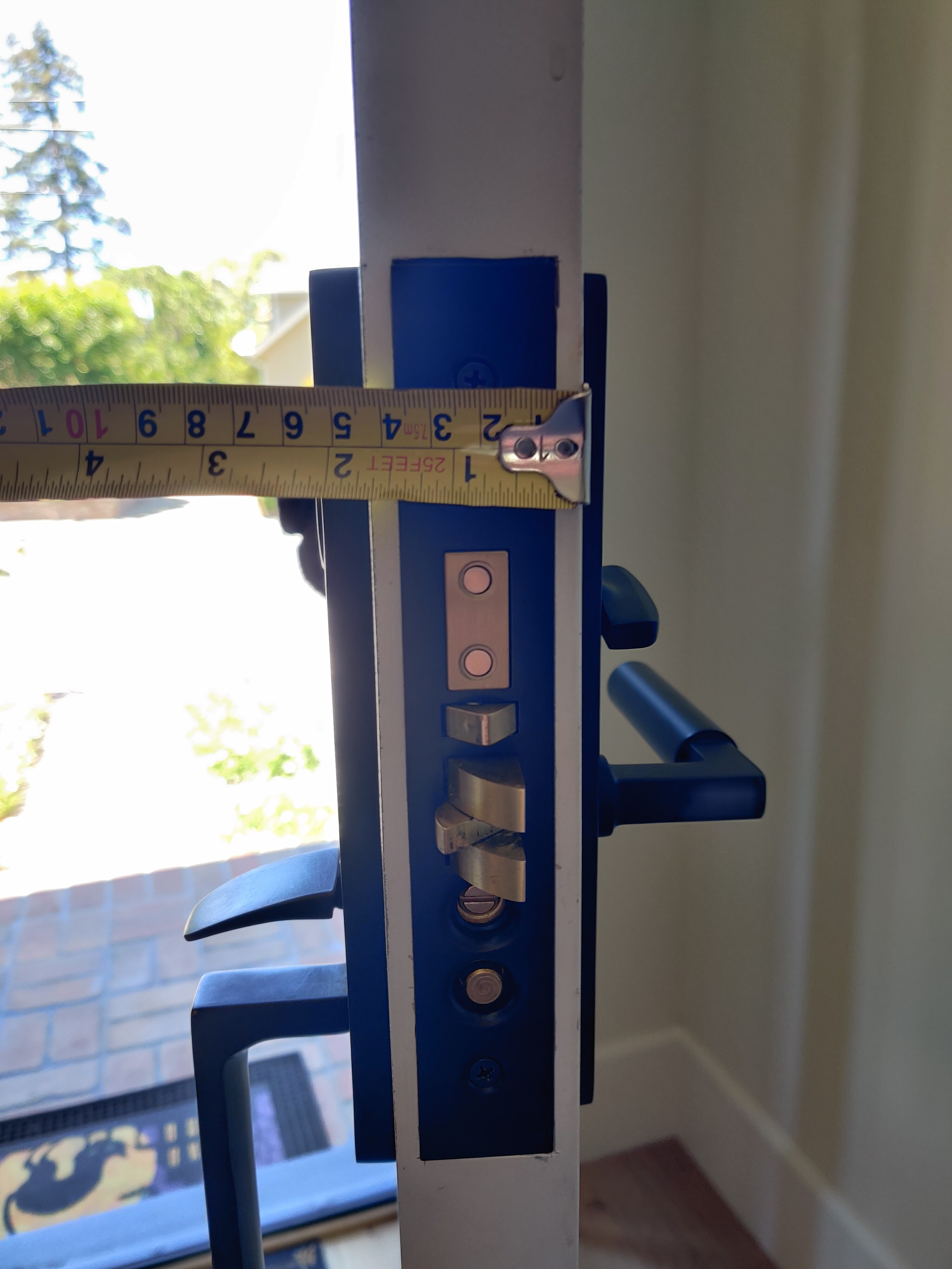

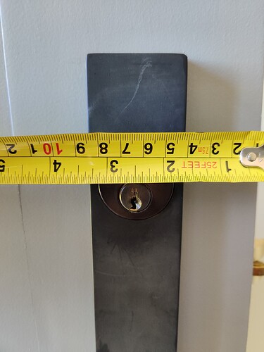

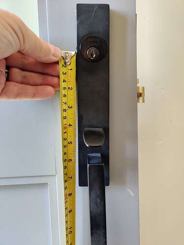

I don’t care so much about the handles, can you take a photo, and measurements of the edge of the door where the lock protrudes.
Measurements to centre of keyhole from edge and distance between keyhole and handle would also be handy.
It is probably standard dimensions, but having the details will help find you a good answer.
Ok, I took some photos with a tape measure:
From the edge of the door to the center of the lock is 2 1/2", from the lock to the handle is 4"

No problem, the handles look very similar, but the bit inside the door is the actual functional part.
I think your best bet might be to contact a local locksmith as they will have specific stock that they are used to, and can hopefully suggest something. A lot of the mortise solutions I am seeing are intended for commercial access control systems (hotels, schools, offices) but you probably want a standalone, maybe even residential, system.

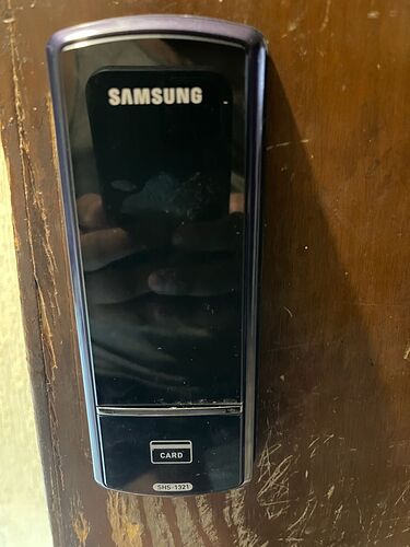

Con mi implante NeXt
Pude abrir la chapa Samsung SHS-1321 que compre hace un par de semanas
