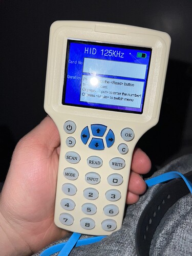

Hey what did you use to copy Your hid tag to the implant. The read/writer (photo below) can read my card from work but will not write the information to my next implant. Any help would be much appreciated. Thank you in advance
Proxmark3 Easy
Thank you. I just put a order in for one
