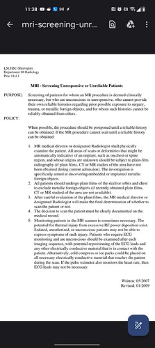

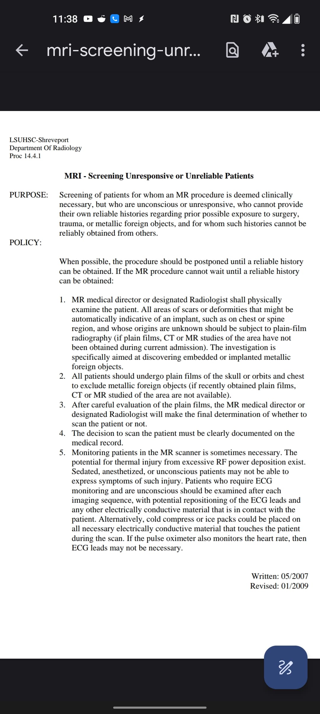

Found this for how to deal with unresponsive patients who need an MRI. It goes over visual inspection for scars indicative of surgery, and using CT scans to rule out metal objects before the patient receives an MRI.

They state that only the chest and head is scaned for metallic objects. I assume it’s the same for the physical examination :thinking:
Yes plain films for head and chest, but the search for scars is full body. I assume they would CT an area that has scars or deformation to rule out implants if they found something along the extremities before signing off on the MRI.
