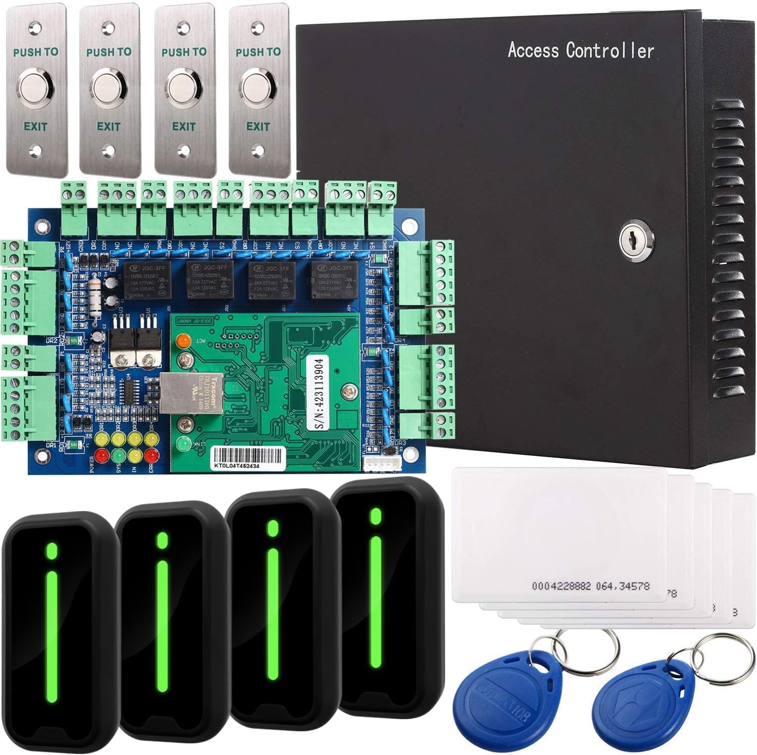

Hello Satur9 - Wiegand 26 control board with 125kHz reader so LF

Thanks for the help. I tried to enroll the chip by directly reading it into the system using the dangerousthings reader and got the displayed error. I will try to scan it on the door reader itself and see what shows up because it might be a different number or reading that will actually function. Maybe it will truncate the number on the reader and be happy? Who knows. Getting into the office was a big hope for my NeXT so hopefully I will get it working. My girlfriend and I are buying a home next year and I do plan to put RFID readers all over the house so at least then it will be very useful.
Well there’s your problem! The KBR1 is HF.
Yep, theres your solution! There are many different ways to interpret the same 1’s and 0’s. If you scan on a door reader, then look in the logs to see if it has the number of the unauthorised tag you should be able to copy it from there.
I’ve successfully enrolled the LF side of my NExT into 3 UHPPOLTE Weigand 26 controllers now, each time by doing a direct read on the door readers. I have EM type USB readers on the system management computers but they’re generic readers and I found they have issues reading the T5577 chips in general. So the door readers work and each controller actually displays a different ID number from the NExT which I think is pretty cool too.
I just enrolled myself today using the UHPPOTE wiegand 26 controller and compatible reader. Worx!
Thanks, everyone for your input on this. Kdude0 thanks for the confirmation it also worx for you too.
You’re welcome, I’m glad it’s working for you :+1::grin:
I’ve been looking at this same board, but detailed info is a little short. Can it be used standalone, or does a pc need to be always on?
I’ve not looked at it specifically but control boards keep their lists internally. The PC is used to manage that list though. I’ve never seen a commercial access control board that requires a PC to perform the authentication portion of its function.
I currently use this exact board albeit with a HID Prox reader so I don’t have to use different keys for building common areas and my apartment. The programing of the board is done via PC over ethernet. I use a WIFI Bridge to access it as I did not want to run cable… management functions and remote unlock etc. are available via the desktop software.
That said, this board is a program once and forget about it kind of thing… unless you want to provision new users or check access logs.
I am upgrading to the Unifi Access Control solution mentioned on another post for the cool factor but its essentially the same thing.
Hey wassssssup? With the system I have at home, the controllers will fully function without the PC connected. The software that runs on the PC is mainly for adding and deleting cards, and configuring access for the cards/users. If you do leave it connected with the PC software all the time, then the PC can do active monitoring and logging of every card swipe, door open/close, etc. :wink:
