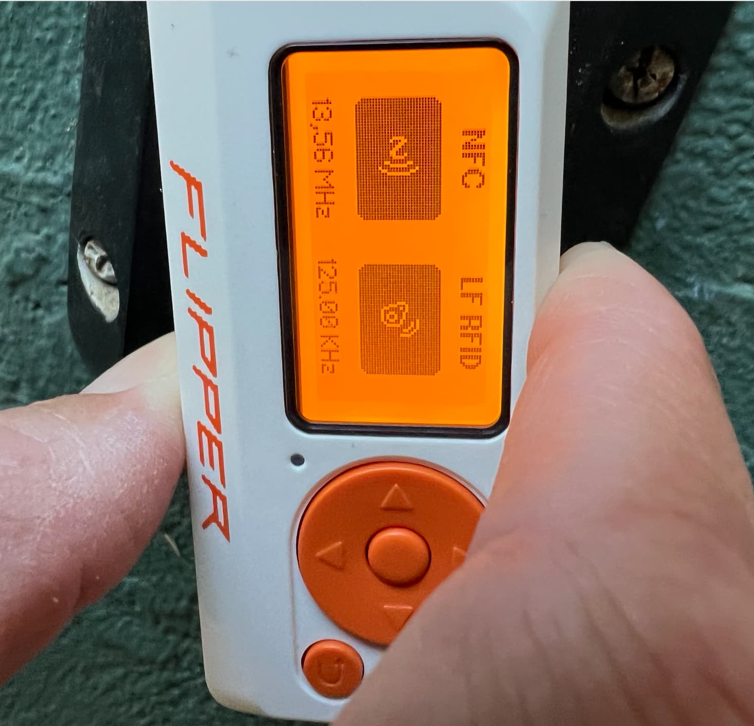

I’ve been trying to crack a Mifare Classic 1K fob with the Flipper Zero but hit the wall after trying everything suggested by the community here at DT (another thread). I’m still a newb so I am going to try to lay out my question and the thought process behind it.
I decided to step up my game and invest and get either a Proxmark3 Easy or RDV4 I don’t mind spending more money for the RDV4 (I can hear the adage “buy cheap buy twice” ringing in my ear) but I am now realizing that since I am Mac based I will also need to buy a Laptop (now the investment is really snowballing) running Windows to even operate the PM3. So my question is should I get a Windows 10 or Windows 11 laptop? (have seen some discussions about Windows 11 being glitchy ((if you recommend Windows 11 – does it matter if it is Home or Pro?)))
Unless someone chimes in and says dude its so easy to run this on Mac OS 14+ which of the below combos do you all recommend for a newb to get the job done cracking this darn Mifare Classic 1K fob (pictured below):
