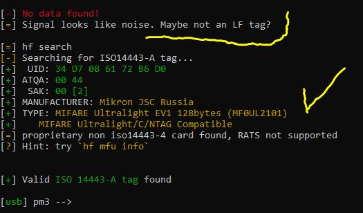

I figured out writing and copying tags to the LF side (on the built-in LF chip of the T5577 series) using my “Proxmark3 easy”. :+1:
BUT I did not find a manual for working with the other “HL” side of NExT (NTAG 216) on "Proxmark3 easy".
Please tell me this step-by-step process of cloning a keychain from the front door, or give me link see.

Short answer: you can’t …
The tag you have is mifare ev1, but the NExT has an ntag216 … Totally different chip …
(I’m not even sure you can clone mifare ultralight EV1 …)
The best way to play with the ntag216 is straight with your phone (if NFC compatible)

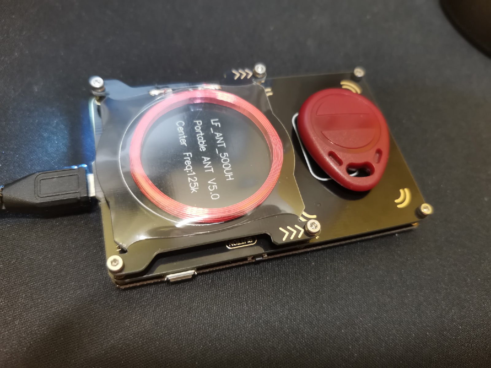

yes, in the screenshot above it is this tag and what “Proxmark3 easy” read
this ^
while you arent able to clone a key onto it, if the system you’re trying to access supports mifare ultralight (and in some cases any ISO14443A UID dependent authentication) you can ask the system administrator whos in charge of the access control systems to enroll your implant as a new token.

now there is a problem to duplicate this tag, which is higher in the screenshot and photo. on a new clean keychain tag
