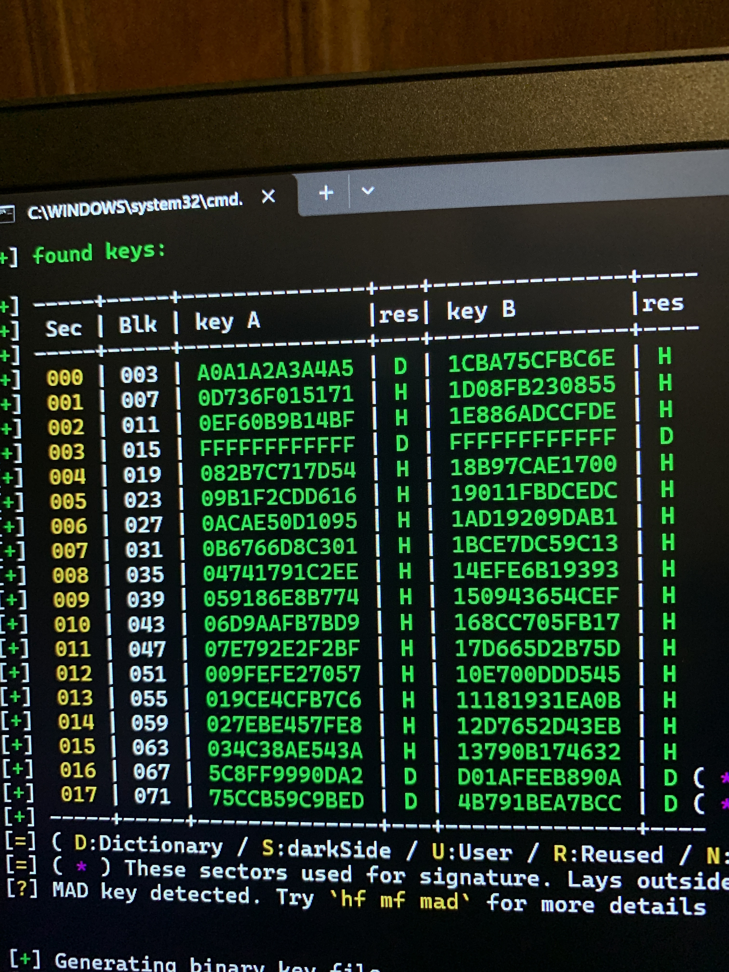

Writing a dump on a non magic mifare classic v1
hi i dumped a card an now i need to write the dump on a non magic card. i used proxmark3 easy. i read in another post that this is possible but i need the key file of the new non magic card. i found the new card keys always with proxmark but i don’t know how to use that. are you sure the uid is writable with new card keyfile?
tnx
You’d use the hf mf restore command
https://siliconbased.us/pm3/ref/hf-mf-restore-help.php
Yours should look something like:
hf mf restore -f <Dump file of source card> -k <key file of target card>
And you may also need the --ka flag, I’m not totally certain
If it’s a non-magic card this won’t overwrite the UID or other non-rewritable info on the card
But, some systems don’t utilize the UID, so it may still work for you
i read of restore command for magic card after the uid mod, i was thinking hf mf cload. what do you think?
hf mf cload is specifically for magic gen1a cards, it will not work for a non-magic card
hf mf restore -f hf-mf-source card-dump.bin -k hf-mf-target card-key.bin
is this the correct syntax?
all files in the same dir were they was created, right?
the --ka flag is used at least with kay A?
tnx
are you trolling? you’ve been told multiple times now on multiple forums that you cannot change the uid of non magic cards.
that’s what magic cards do. change their UID. it’s not something normal cards can do.

well I tried the command hf mf restore -f hf-mf-6E7BE4FB-dump.bin -k hf-mf-F059B2B1-key.bin and this was the result:
[usb] pm3 → hf mf restore -f hf-mf-6E7BE4FB-dump.bin -k hf-mf-F059B2B1-key.bin
[+] Loaded binary key file hf-mf-F059B2B1-key.bin
[=] Using key file hf-mf-F059B2B1-key.bin
[+] Loaded 1024 bytes from binary file hf-mf-6E7BE4FB-dump.bin
[=] blk | data | status
[=] 0 | 6E 7B E4 FB 0A 88 04 00 C8 38 00 20 00 00 00 15 | ( fail ) key B
[=] 0 | 6E 7B E4 FB 0A 88 04 00 C8 38 00 20 00 00 00 15 | ( fail ) key A
[=] 1 | D5 00 26 88 26 88 69 88 00 00 00 00 00 00 00 00 | ( ok )
[=] 2 | 00 00 00 00 00 00 00 00 00 00 00 00 00 00 00 00 | ( ok )
[=] 3 | FF FF FF FF FF FF 78 77 88 00 FF FF FF FF FF FF | ( ok )

[!] Strict ReadOnly Access Conditions on block 2 detected
[=] Skipping, use --force to override and write this data
[!] Strict ReadOnly Access Conditions on block 3 detected

[#] Auth error

several unwritten blocks
then I tried hf mf restore -f hf-mf-6E7BE4FB-dump.bin --force

to understand what happened to the tag I tried to extract the keys:
[usb] pm3 → hf mf auto
[=] MIFARE Classic EV1 card detected
[+] loaded 5 user keys
[+] loaded 61 keys from hardcoded default array
[=] running strategy 1
[=] running strategy 2
[+] target sector 0 key type A – found valid key [ A0A1A2A3A4A5 ]
[+] target sector 3 key type A – found valid key [ FFFFFFFFFFFF ]
[+] target sector 3 key type B – found valid key [ FFFFFFFFFFFF ]
[+] target sector 16 key type A – found valid key [ 5C8FF9990DA2 ]
[+] target sector 16 key type B – found valid key [ D01AFEEB890A ]
[+] target sector 17 key type A – found valid key [ 75CCB59C9BED ]
[+] target sector 17 key type B – found valid key [ 4B791BEA7BCC ]
[+] found keys:
[+] Sec | Blk | key A |res| key B |res
[+] 000 | 003 | A0A1A2A3A4A5 | D | 1CBA75CFBC6E | H
[+] 001 | 007 | 0D736F015171 | H | 1D08FB230855 | H
[+] 002 | 011 | 0EF60B9B14BF | H | 1E886ADCCFDE | H
[+] 003 | 015 | FFFFFFFFFFFF | D | FFFFFFFFFFFF | D
[+] 004 | 019 | 082B7C717D54 | H | 18B97CAE1700 | H
[+] 005 | 023 | 09B1F2CDD616 | H | 19011FBDCEDC | H
[+] 006 | 027 | 0ACAE50D1095 | H | 1AD19209DAB1 | H
[+] 007 | 031 | 0B6766D8C301 | H | 1BCE7DC59C13 | H
[+] 008 | 035 | 04741791C2EE | H | 14EFE6B19393 | H
[+] 009 | 039 | 059186E8B774 | H | 150943654CEF | H
[+] 010 | 043 | 06D9AAFB7BD9 | H | 168CC705FB17 | H
[+] 011 | 047 | 07E792E2F2BF | H | 17D665D2B75D | H
[+] 012 | 051 | 009FEFE27057 | H | 10E700DDD545 | H
[+] 013 | 055 | 019CE4CFB7C6 | H | 11181931EA0B | H
[+] 014 | 059 | 027EBE457FE8 | H | 12D7652D43EB | H
[+] 015 | 063 | 034C38AE543A | H | 13790B174632 | H
[+] 016 | 067 | 5C8FF9990DA2 | D | D01AFEEB890A | D ( * )
[+] 017 | 071 | 75CCB59C9BED | D | 4B791BEA7BCC | D ( * )
