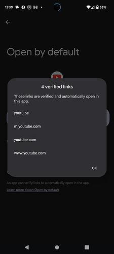

So I’m trying to find out how to write the YouTube url so that when my xsiid is scanned it opens the YouTube app and not the mobile website. I’ve tried the direct link, I’ve tried the youtu.be link. I’ve even tried a marketing campaign link from URLgenius. Running out of ideas.

I’m using the pixel 7. But I also have a test pixel 3 and S7 I use.
I have already enabled the URLs to open the YouTube app by default but it still reverts back to the mobile site
This is entirely dependent on the phone and the app on the phone catching the hook for the URL.
Alternatively you can write an intent that will work on Android but not iPhone to open a specific app. How to use NFC tag to open APP directly android - Stack Overflow
