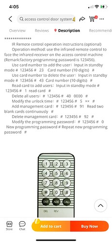

A couple of them appear to include the IR receiver that the xac is wired for but doesn’t include
And it looks like the ir port is for some higher level programming stuff
Maybe you guys can make a bit more sense of this than me

But perhaps we can use the IR function on the xac (the sensor isn’t included though so we’d need to make one)
To maybe tweak the exploit… assuming it could be some version of the programming code mentioned above
@Pilgrimsmaster @TSMC55 well let’s hear it

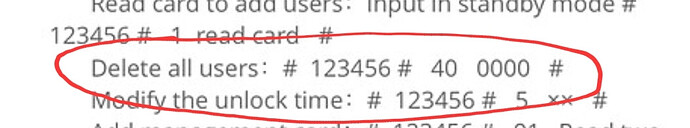

The control unit above has it. All it does is allow you to add or delete cards by using the remote to enter programming mode and then either swiping the cards or entering their UID (via the remote).
Some of the controllers can also use a keypad (which is connected wirelessly 433KHz) and the code for that can also be programmed via the remote.
It allows for bulk deleting of cards as well, and for changing the length of time the relay is activated.
There is not really anything special about it.

I was looking at the “new programming password”
That’s probably similar to what I tried,
I burned a iso card with the exploit ID
I then tried to delete it with the
Master remove tag
Exploit tag
Master remove tag
No dice
All that does is change the default code (123456 from memory) to enter programming mode (which is the mode I described above).
