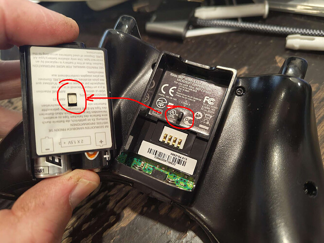

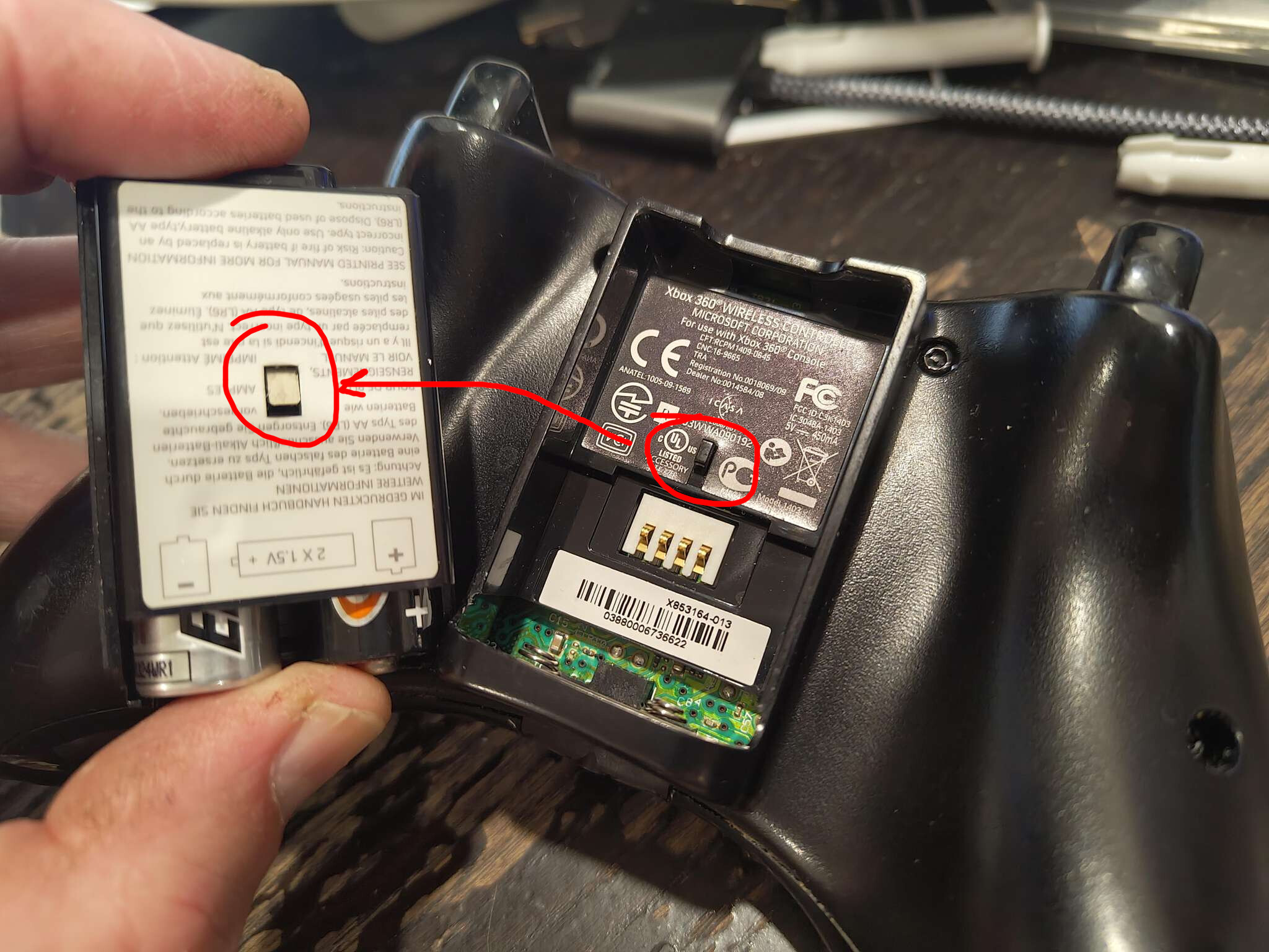

The AA battery pack is wired in series so the 1.5v AA batteries are connected together inside the pack for a total voltage of 3v at the ends sticking out of the pack, which make contact with the springs inside the controller when the pack is inserted. For safety, the battery pack has a small contact switch inside that connects the two batteries together once inserted into the controller. Remove the pack from the controller, and the batteries are disconnected. This ensures that shorting across the two exposed ends of the batteries won’t do anything because they are disconnected on the inside of the pack.
Nice idea… brilliant even. However, the switch is a simple flap of metal that contacts another simple bump of metal inside. Over time this becomes dirty and corroded and there is no way to really clean it without disassembling the pack, which is possible even though it’s not meant to be opened. Once this switch is fouled up, you’ll notice the controller randomly powers off even if the batteries are good… especially when setting it down or getting into some serious controllering and knocking the pack with your fingers. This enraged me to the point I took the pack out and tried to figure out what was going on.
The little plastic tab on the controller presses into the metal flap in the center of the pack, which pushes this metal flap into another metal bump inside the pack to make the connection.

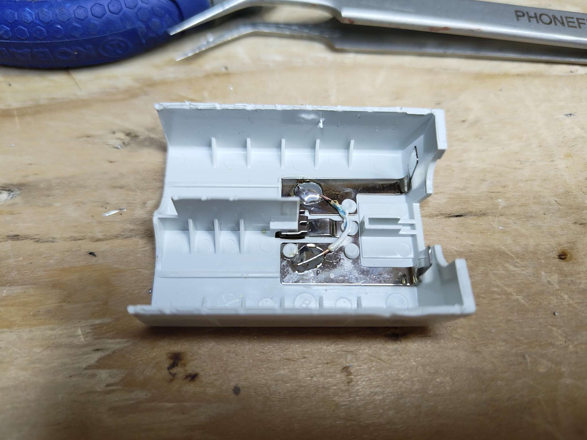

The video is about cleaning the battery contacts, which may need to happen from time to time… but really the trick he missed was jumpering the two plates to bypass this safety switch. I never have batteries in the pack when it’s out of a controller, so for me this is not a safety issue.
Once the pack is in two pieces, do your cleaning but solder these plates together.
Now my controller is ROCK SOLID, even when in hard core gaming mode.
