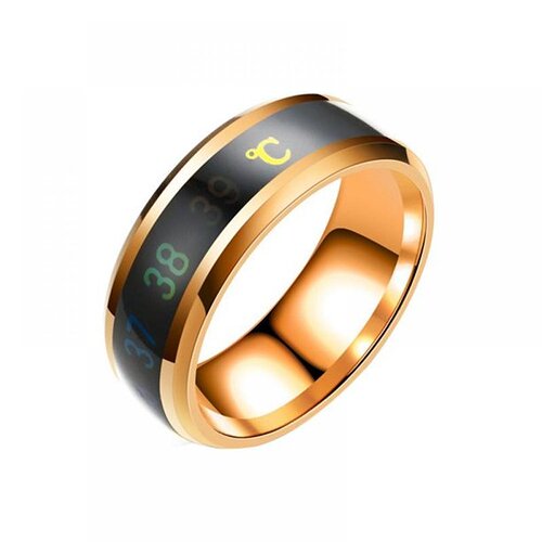

Its hard to beat something like this:
Also, not quite “injectable”, but: Ingestible Thermometer Pill
Except it’s kinda useless… it reads your finger temperature, which isn’t helpful for medical diagnosis.
