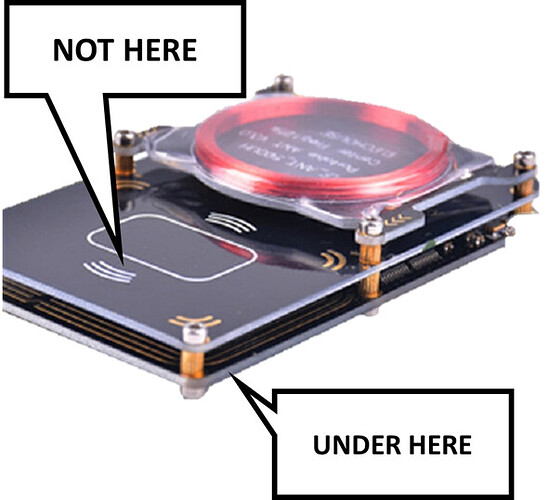

Are you using the "underside: of the bottom PCB?

Not wanting to insult you, because I know you have been around for a while, but just making sure, because it is a little trick for xSeries. Placing on top with a full sized card or fob it reads fine, but we need to stack the odds in our favour with our implants
