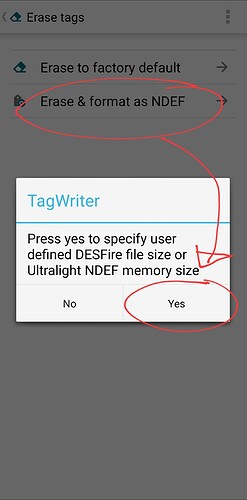

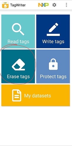

it sounds like you just want an NDEF container.
Use Tagwriter -for iPhone in the app store

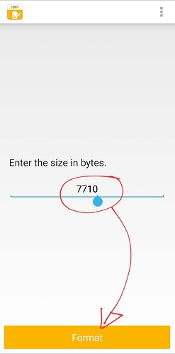

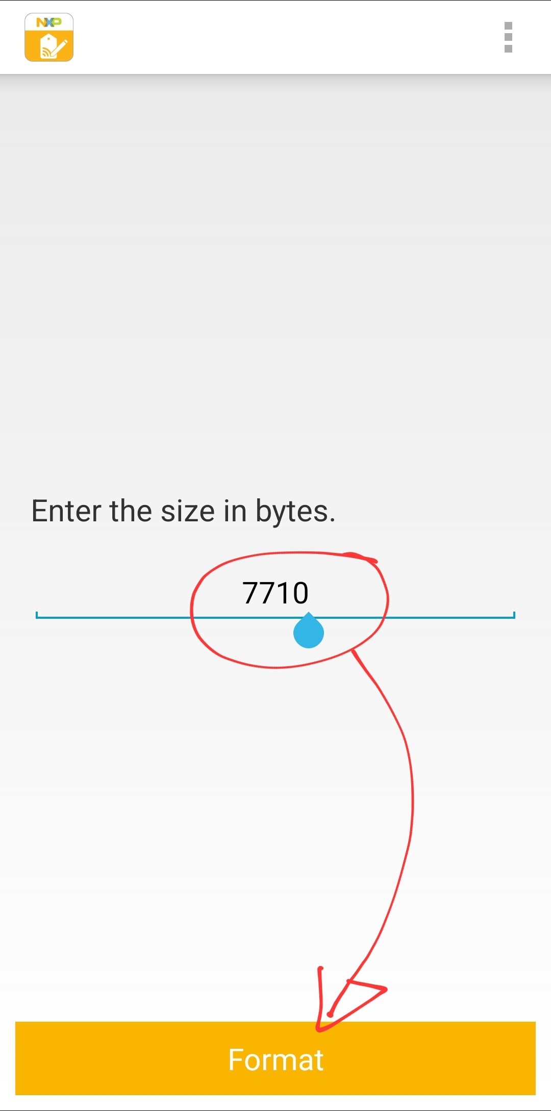

Format NDEF to
7710 bytes
Answering no creates the largest NDEF container by default. At least on the Android version.
