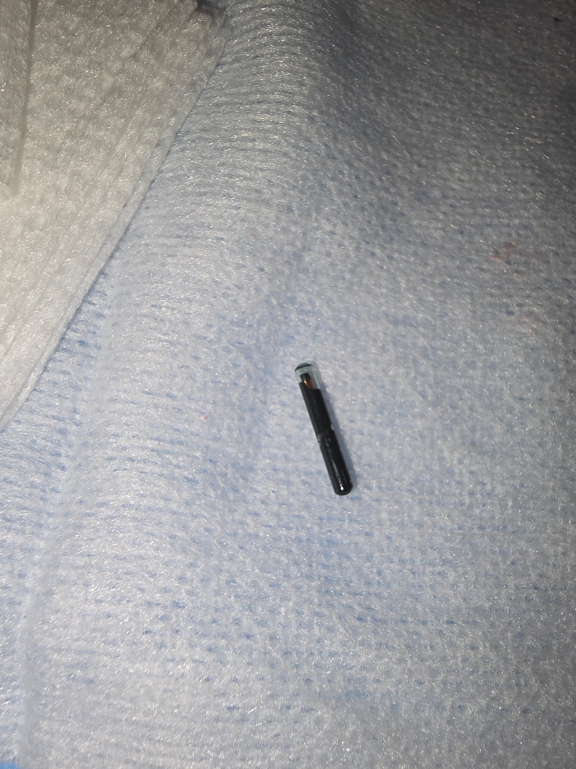

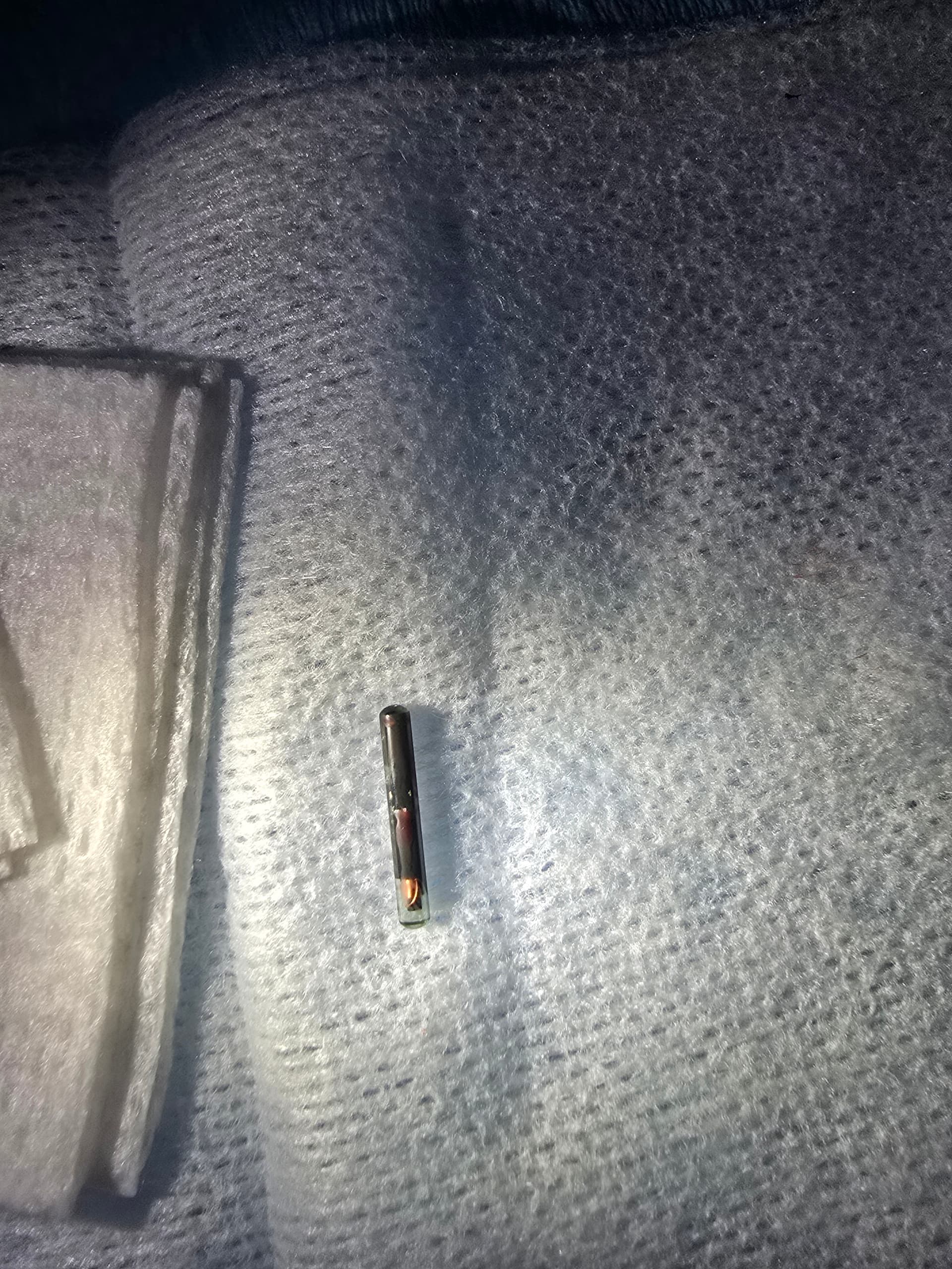

Can you post some high res photos of your NExT?
Nfc isnt as robust on the next as the xem, but 125khz is really weak. Ive attached some photos. Let me know if you need more, I left it at the installer’s shop so it will take a few days to get more.

So the xMagic is a 3mm diameter product and inside the ferrite antenna rods are slightly wider diameter and performance is slightly better. Still, the NExT should still perform just fine with the Flipper & Proxmark for 125khz. What kind of issues are you experiencing? Problem reading? Problem writing / updating?

Since you have two implants with nearly the same construction, particularly for the T5577 chip (the LF module in both xmagic and next are the same) then it seems to me perhaps the NExT T5577 module is underperforming.
