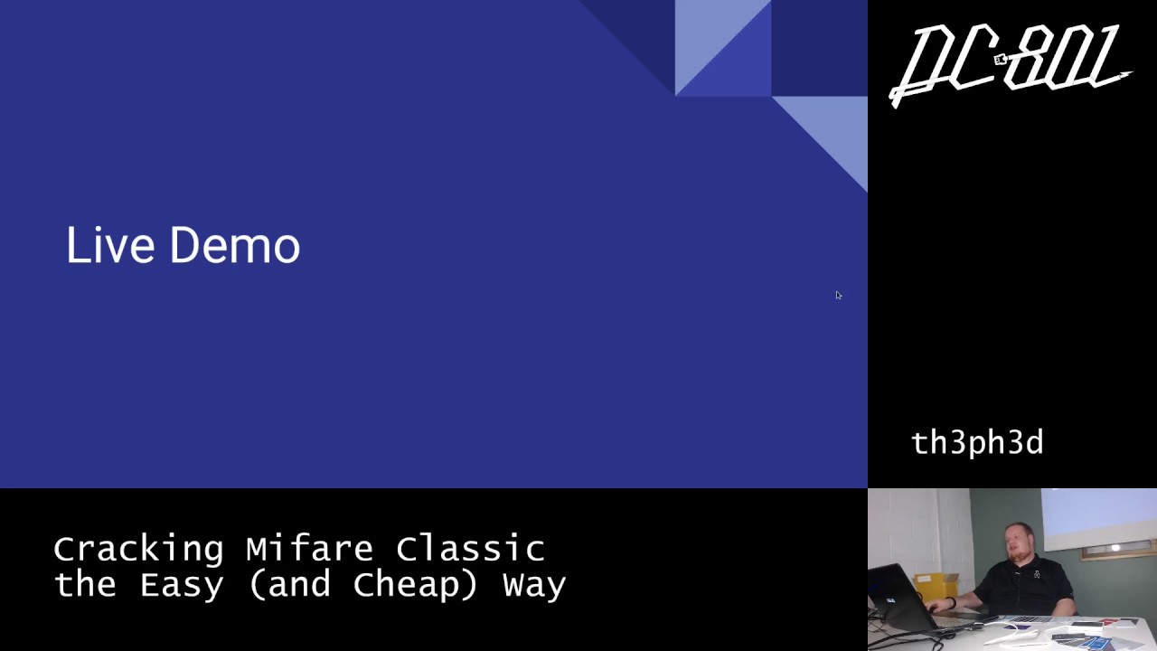

Here’s a video we did at our Hackerspace on cracking Mifare Classic:
We use this method quite frequently to play with Mifare Classic cards.
