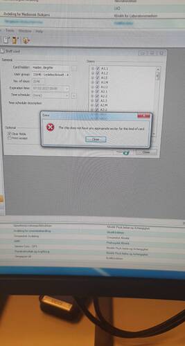

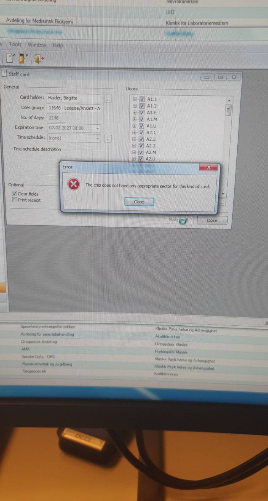

With work card: all ok
With flexM1: “the chip does not have any appropriate sector for this kind of card”

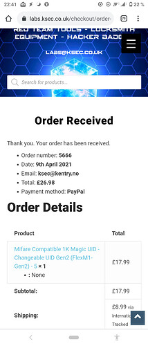

Grab yourself a Gen2 Test card and try that sucker, there might be a solution for you yet buddy!!!
https://labs.ksec.co.uk/product/mifare-classic-compatible-1k-magic-uid-changeable-uid-gen2/
