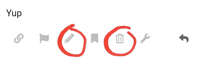

You can edit your post and remove the sensitive parts which will “hide” the post but it will still be visible if people check out the edits.
So then delete, but that will take 24hrs to “disappear”
To share your info, you can just delete or “photoshop” out the sensitive parts.
or if you “have” to you can DM somebody.
