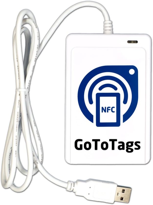

alternatively, you can buy a USB reader thats cheaper than a phone for about £35
ACS ACR122u is a good one and works with the xNT etc
I double checked my carrier and phone and also picked up this
but still no read. When I open the DT app I enter a password and nothing…I don’n think mine works
Did you install the proper drivers for the ACR122U reader, because just plugging it in will not result in a working reader.
are you positioning your xNT in the proper place?
