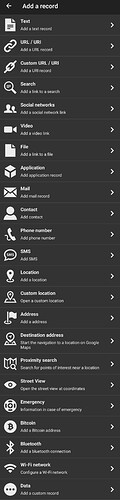

NFC has a number of uses, as an example
So if you want something like that, the NExT would be the better choice.

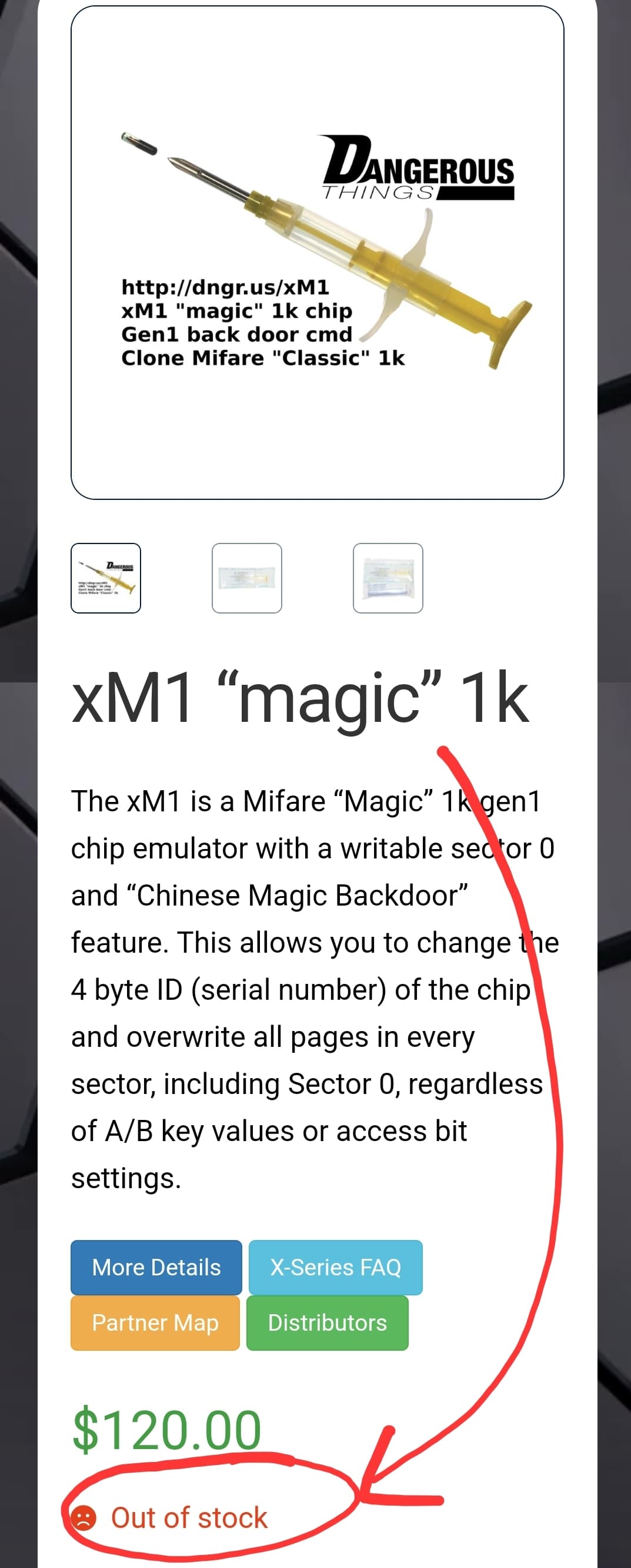

I dont believe it will be coming back into stock any time soon.
There is a project for an alternative, but I cant give you a date for that…
