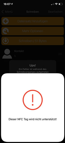

XSIID Blue writing problem
With the NFC Tool i can t write the TAG
Can anyone help me

Reading is very good and with the iphone automation is good working, but i can t write

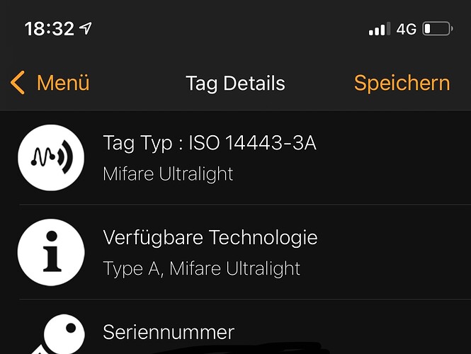

With the NFC Tag Info is this but the writer doesn t go

I have to formatting to NDEF.
Now it Works with the writing
