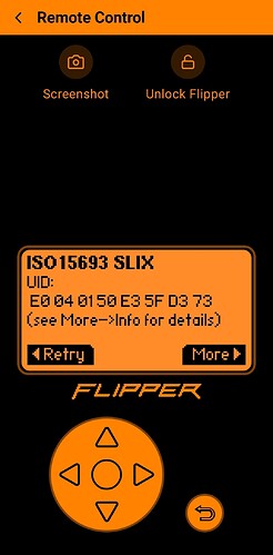

If you dont get any response, I MAY have a solution for you, but youll just have to bear with me for a while
FYI
I made this from an incorrect order I recieved from AliExpress, it has an SLX chip, but it is more than likely what you would get in a card anyway,
Basically a FlexSLX rather than an xSLX
Anyway
I am away from home (where it is) at the moment, But I can send you a scanned copy when I get back if you would like…
Would a FlexSLX and the xSLX have the same first 4 bytes? If so, knowing that and being able to test at the arcade on Friday just to be sure would be very helpful, thank you ![]()
So this one also starts with E004, so I’d assume if I got a xSLX, it would probably also start with that? So I’d be able to use it for e-amusement ![]()
As I mentioned, the E0 byte is the manufacturer code, so it will be the same for all NXP chips, and 04 is the first of the two byte chip product code, so every NXP ICODE SLX chip will always start with these two bytes.
