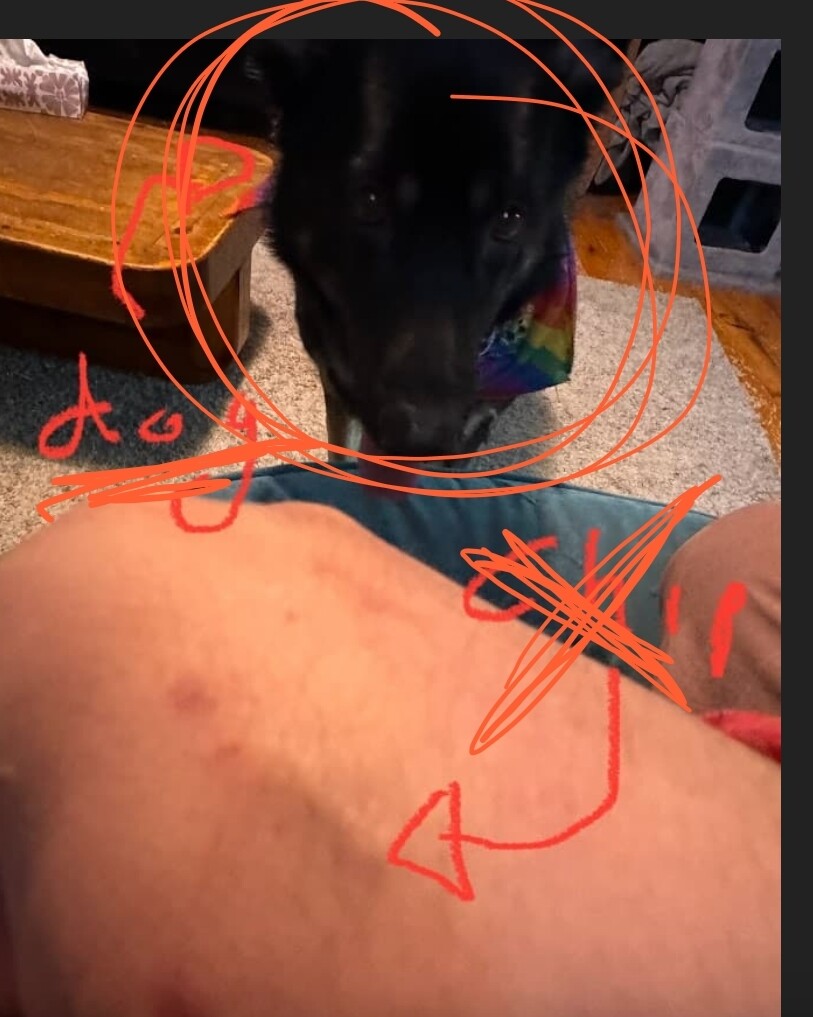

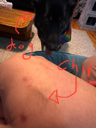

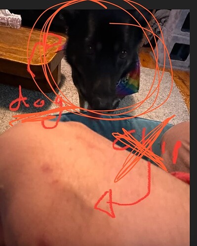

  • On my right hand, yeah. The one on my left hand seems to have been installed signficantly deeper + got turbo punched by Arceus the dog (see below) so it’s not out of the realm of possibility the left one is still healing

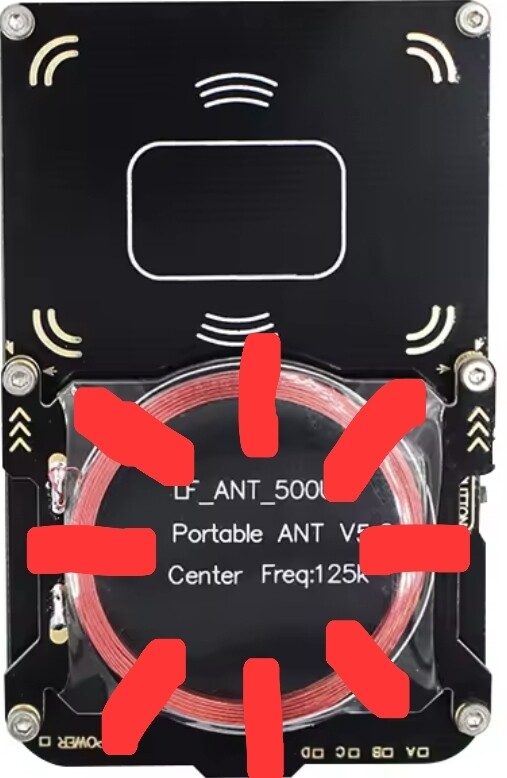

the oriention of implant should be something like one of these.
Also try reading at either end, it can make all the difference…

Your xLED looks nice and shallow, but when “reading” with commands above, try pressing firmly into the implant.
Do your best contortion act to be able to see the light because it is easy to cover with the PM3.
To refine your placement even more, try a
lf tune
Place your PM3 on your xLED and look for the lowest Voltage reading you can find.
Take a mental image of this placement, and replicate this the best you can
