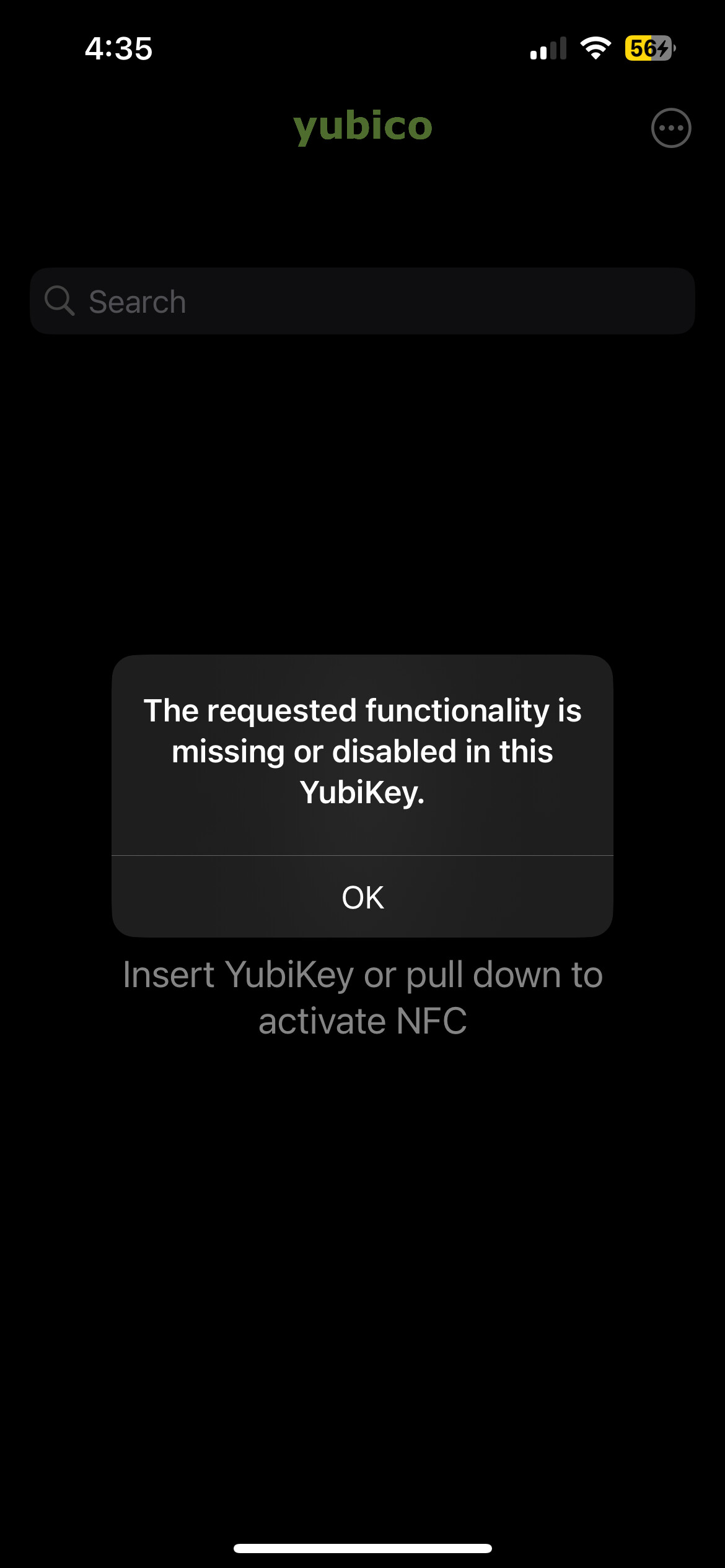

Hey there. I’ve been using the OTP Authenticator applet on my Apex Flex with Yubico’s Authenticator app on my iPhone. But a new update to the app causes it to crash instantly on a successful read. The offending version is 1.11, which is supposed to add support for FIPS yubikeys.
Anyone else having the same problem? I could destroy and reinstall the applet and see if it helps, but I’m hoping that I don’t have to.

I installed the update on my test iPhone and I’m seeing the same with my apex :confused:
Actual yubikeys are working fine, but the javacard I have loaded with the TOTP applet is erroring out. Not closing/crashing out of the app like my apex does, but says “YubiKey connection is not found”.

As of this morning, I get an error and the message “YubiKey connection is not found” when using Yubico Authenticator. This always worked before, so I’m hoping it’s a temporary problem.
When I use the Fidesmo app, it seems to connect fine. Any ideas?
Unfortunately same behavior after doing that :confused:

I have had my apex since the bata and used the OTP applet for years at this point and today I went to login to something and needed my one time password and scanned my hand and got an error in the yubi app, not a huge issue, I know that app on iphone has issues sometimes, but I scanned many times and kept getting errors. So I broke out my old android with the official authentication app and when I scanned it the app said “Vivokey OTP not installed” I can still read the ndef record with no issues so I know the chip works fine. I then continued down this hole and trying to figure out what is going on, so I opened up the fidesmo app and it says all my applets are happy and fine, then I remembered the cybernetic app on my old android, last time I used it the app was new, but to try everything I opened it up and it sees all of my codes! The android app also shows all of my memory and everything just fine, so I went to look to see if an iphone app existed and it does, but looks like the iphone app is pretty broken. I says 100% of memory is free, the authenticator part doesn’t work and says this feature is coming soon.
